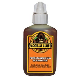

Gorilla glue is a special glue trademark of the Gorilla Glue Company. It is a polyurethane based expanding adhesive that can stick to more or less anything. It is water proof.

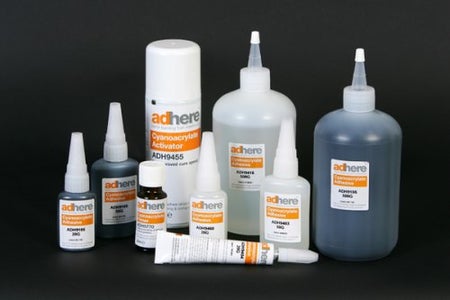

Another speciality adhesive is known as plastic cement which is made up of cyanoacrylate. It basically bonds plastic at a molecular level and the bond becomes seamless. It is very useful to have if you are going to work with plastics.
