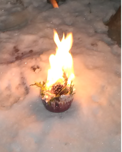

Place paper muffin holders in muffin pan, then fill 1/3 of the each of the holders with dryer lint.
Step 3: Add Some More
Push a pine cone in the center of each fire-starter, then put wood chips around the pine cone.
Step 4: Melt Some Wax
Place Candles in pot, heat pot on stove at medium temperature (carefully, combustible vapors are formed here). keep watch over the melting wax until it is fully melted.
Turn off the stove for now.
Then fill the fire-starter half-way with hot wax (be very careful!).
It was suggested to me that i should have used a double boiler and monitored it with a candy thermometer.
Step 5: Let Stand
Let sit for about 1 minute then carefully push the evergreens into the fire-starter. Place a little of the shredded paper on the top of each one.
Step 6: Fill With Wax
Turn back on the stove, heat back up the wax, and carefully fill each fire-starter with the candle wax.
Step 7: Pop Them Out
Let sit until they are hard, mine took about 2 hours to be completely solid. Next you need to pop them out, do this be pressing firmly on the bottom of the muffin pan. You might bend the pan, this is why we used an aluminum foil one.
Step 8: Let It Burn
Make a fire, Sit back and enjoy the warmth of a job well done.
