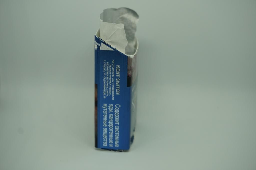

Step 3: Removing the Foil
Remove the foil from inside the pack, taking care not to tear it. Once the foil is removed, reverse it so the shiny side is facing inwards. Then reinsert the reversed foil into the packet. This provide a reflective surface to bounce the light out of the box.
Note: With some brands of cigarettes, you can skip this step as the foil is already facing shiny side in.

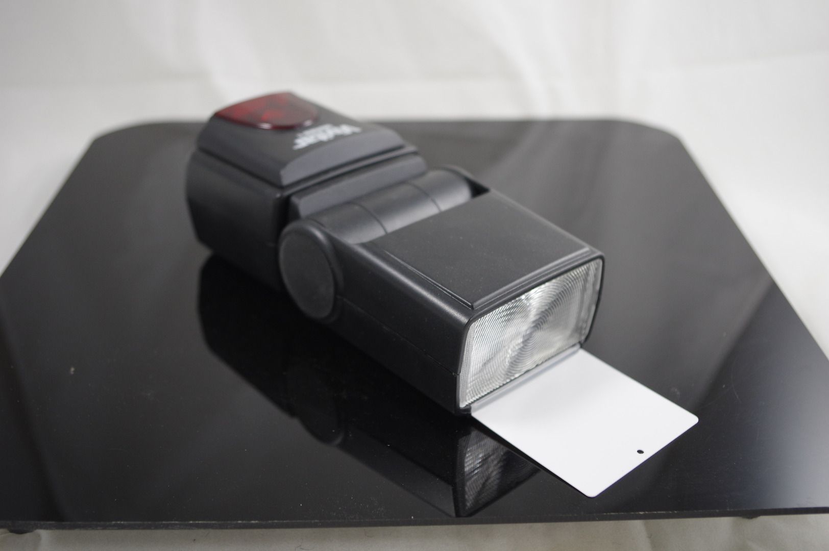

This is not a good idea. The color in the box diffuser will be introduced into whatever your subject is. This can also introduce a color crossover.
You can simply use a piece of white paper of even tissue paper and a rubber band or tape around the built-in flash for a better effect.
If you are using a flash in the hotshoe of the DSLR camera, simply point the flash up and rubber band a piece of white card to the flash with a the card sticking above the flash by between 2 to 4 inches. Many hotshoe flashes come with a white plastic card for just this reason.
Both of these ideas will work better then a cigarette box.

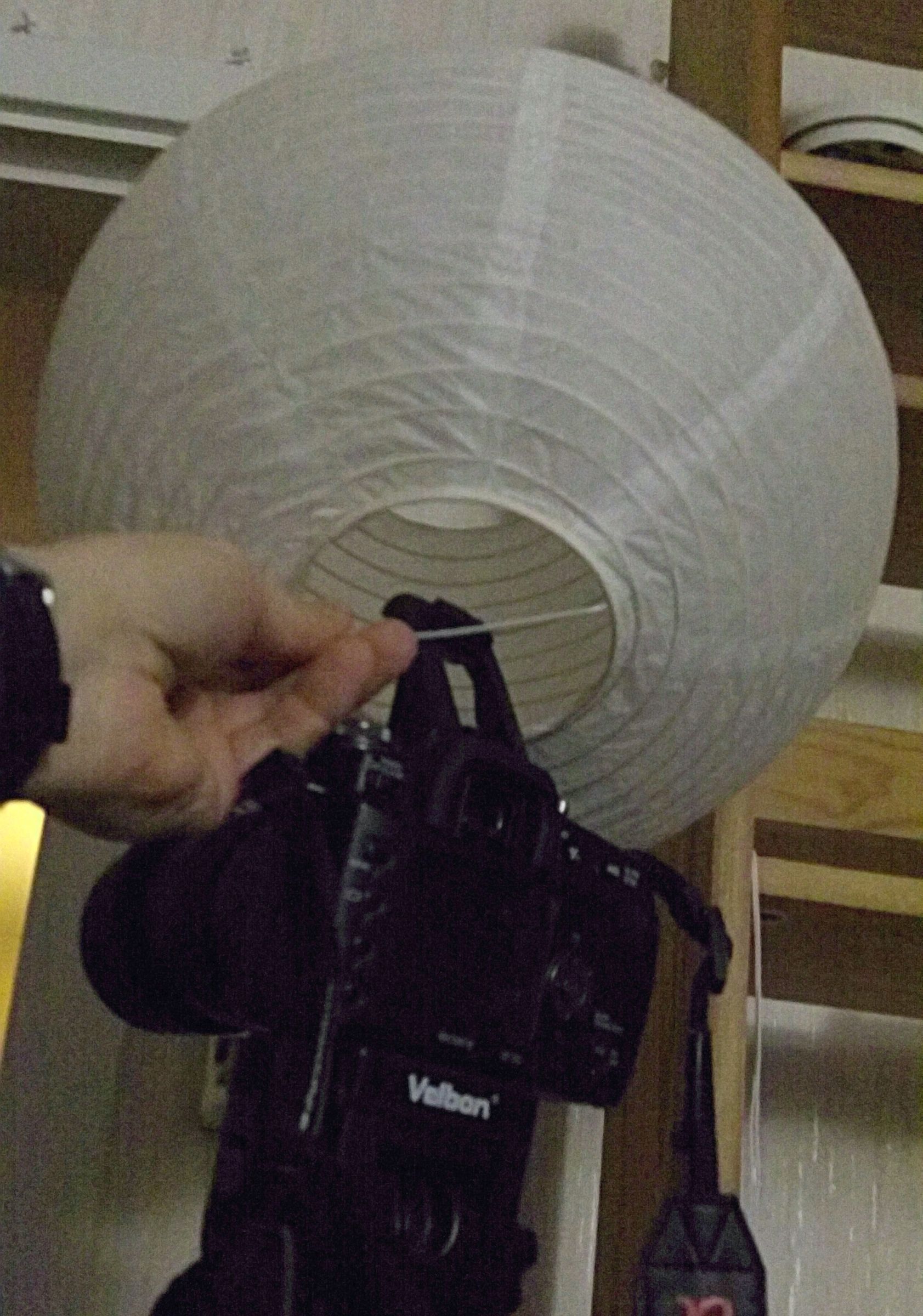

13 years ago on Introduction
Here's my diffuser -a rice paper lamp from IKEA:
