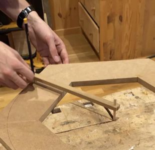

In my case, the diameter was larger than the width of the piece of MDF I had, so I decided to saw out 6 stripes of 10 cm wide and 30 cm long. Consequently, I sawed 60 degree angles on the side so they could be assembled to a hexagon. Use wood glue to glue the pieces together and keep them together until the glue has dried using a strap.
As I did not have a large enough compass, I made one to fit the correct diameter by drilling two holes, one for a pen and one for a wooden rod, into a strip of wood. Then put the wooden rod in the center of the hexagon and draw a circle.
Finally, use a jig saw to cut out the circle.
