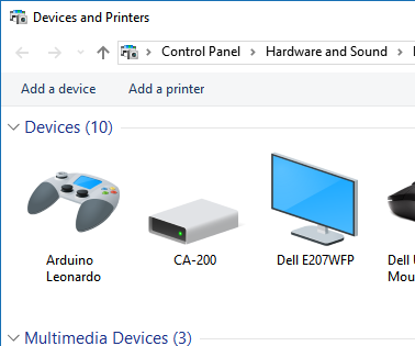

The following Arduino Sketch file should be compiled and uploaded into the Arduino Leonardo or Arduino Micro: JoystickToKeyboard.ino
<p>// ColecoVision / ADAM Joystick to PC Keyboard Converter<br>// for the Arduino Leonardo // 2014-08-24 //-----------------------------------------------------------------------------</p><p>// Joystick Pins const byte gcFirePin = 2; const byte gcUpPin = 3; const byte gcDownPin = 4; const byte gcLeftPin = 5; const byte gcRightPin = 6; const byte gcModeAPin = 7; const byte gcModeBPin = 8; const byte gcFireMonitorPin = 13; const byte gcBit0Pin = 3; const byte gcBit2Pin = 4; const byte gcBit3Pin = 5; const byte gcBit1Pin = 6;</p><p>// Keyboard Keys const char gcUpKey = KEY_UP_ARROW; const char gcDownKey = KEY_DOWN_ARROW; const char gcLeftKey = KEY_LEFT_ARROW; const char gcRightKey = KEY_RIGHT_ARROW; const char gcLeftFireKey = KEY_LEFT_ALT; const char gcRightFireKey = KEY_LEFT_CTRL; const char gcPurpleButtonKey = KEY_LEFT_SHIFT; const char gcBlueButtonKey = 'z'; const char gcAsteriskKey = '-'; const char gcPoundKey = '=';</p><p>// Current Frame Joystick Status byte gLeftFireButton = 0; byte gRightFireButton = 0; byte gUp = 0; byte gDown = 0; byte gLeft = 0; byte gRight = 0; char gNumPadValue = ' '; byte gPurpleButton = 0; byte gBlueButton = 0; byte gBit0 = 0; byte gBit1 = 0; byte gBit2 = 0; byte gBit3 = 0;</p><p>// Last Frame Joystick Status byte gLastLeftFireButton = 0; byte gLastRightFireButton = 0; byte gLastUp = 0; byte gLastDown = 0; byte gLastLeft = 0; byte gLastRight = 0; char gLastNumPadValue = ' '; byte gLastPurpleButton = 0; byte gLastBlueButton = 0;</p><p>// Line Read Variables const unsigned int gcThreashold = 4; unsigned int gLeftFireCount = 0; unsigned int gRightFireCount = 0; unsigned int gUpCount = 0; unsigned int gDownCount = 0; unsigned int gLeftCount = 0; unsigned int gRightCount = 0; unsigned int gBit0Count = 0; unsigned int gBit1Count = 0; unsigned int gBit2Count = 0; unsigned int gBit3Count = 0;</p><p>// Frame Variables const int gcFrameLength = 10; unsigned int gLoopsPerFrame = 0; unsigned long gLastFrameStart = 0;</p><p>// Shows the status of the joystick. void ShowJoystickStatus() { // Debug Information // Serial.println(gLoopsPerFrame);</p><p> digitalWrite(gcFireMonitorPin, gLeftFireButton | gRightFireButton); }</p><p>void SendKeyboardStateToPc() { if ((gLastNumPadValue != ' ') && (gLastNumPadValue != gNumPadValue)) { Keyboard.release(gLastNumPadValue); } if ((gNumPadValue != ' ') && (gLastNumPadValue != gNumPadValue)) { Keyboard.press(gNumPadValue); } SendLineStateToPc(gLastLeftFireButton, gLeftFireButton, gcLeftFireKey); SendLineStateToPc(gLastRightFireButton, gRightFireButton, gcRightFireKey); SendLineStateToPc(gLastUp, gUp, gcUpKey); SendLineStateToPc(gLastDown, gDown, gcDownKey); SendLineStateToPc(gLastLeft, gLeft, gcLeftKey); SendLineStateToPc(gLastRight, gRight, gcRightKey); SendLineStateToPc(gLastPurpleButton, gPurpleButton, gcPurpleButtonKey); SendLineStateToPc(gLastBlueButton, gBlueButton, gcBlueButtonKey); }</p><p>void SendLineStateToPc(byte lastState, byte currentState, char keyUsedForLine) { if ((lastState == 1) && (currentState == 0)) { Keyboard.release(keyUsedForLine); } if ((lastState == 0) && (currentState == 1)) { Keyboard.press(keyUsedForLine); } }</p><p>unsigned int CheckJoystickLine(byte pin) { return (digitalRead(pin) == LOW); }</p><p>void CheckJoystickLines() { const int cLineDelay = 50; // Put Joystick in Direction Mode digitalWrite(gcModeAPin, HIGH); digitalWrite(gcModeBPin, LOW); delayMicroseconds(cLineDelay); gLeftFireCount += CheckJoystickLine(gcFirePin); gUpCount += CheckJoystickLine(gcUpPin); gDownCount += CheckJoystickLine(gcDownPin); gLeftCount += CheckJoystickLine(gcLeftPin); gRightCount += CheckJoystickLine(gcRightPin);</p><p> // Put Joystick in Keypad Mode digitalWrite(gcModeAPin, LOW); digitalWrite(gcModeBPin, HIGH); delayMicroseconds(cLineDelay); gRightFireCount += CheckJoystickLine(gcFirePin); gBit0Count += CheckJoystickLine(gcBit0Pin); gBit1Count += CheckJoystickLine(gcBit1Pin); gBit2Count += CheckJoystickLine(gcBit2Pin); gBit3Count += CheckJoystickLine(gcBit3Pin); }</p><p>void ResetFrameVariables() { // Copy Current Frame to Last Frame gLastNumPadValue = gNumPadValue; gLastLeftFireButton = gLeftFireButton; gLastRightFireButton = gRightFireButton; gLastUp = gUp; gLastDown = gDown; gLastLeft = gLeft; gLastRight = gRight; gLastPurpleButton = gPurpleButton; gLastBlueButton = gBlueButton; // Reset Frame Loop Counter gLoopsPerFrame = 0; // Reset Joysick State gLeftFireCount = 0; gLeftFireButton = 0; gRightFireCount = 0; gRightFireButton = 0; gUpCount = 0; gUp = 0; gDownCount = 0; gDown = 0; gLeftCount = 0; gLeft = 0; gRightCount = 0; gRight = 0; gBit0Count = 0; gBit0 = 0; gBit1Count = 0; gBit1 = 0; gBit2Count = 0; gBit2 = 0; gBit3Count = 0; gBit3 = 0; gNumPadValue = ' '; gPurpleButton = 0; gBlueButton = 0; }</p><p>byte DetermineJoystickLineValue(unsigned int pressCount) { return (pressCount >= gcThreashold); }</p><p>void DetermineJoystickValues() { const char cKeypadValueLookup[16] = { ' ', '6', '1', '3', '9', '0', gcAsteriskKey, ' ', '2', gcPoundKey, '7', ' ', '5', '4', '8', ' '}; gLeftFireButton = DetermineJoystickLineValue(gLeftFireCount); gRightFireButton = DetermineJoystickLineValue(gRightFireCount);</p><p> gUp = DetermineJoystickLineValue(gUpCount); gDown = DetermineJoystickLineValue(gDownCount); gLeft = DetermineJoystickLineValue(gLeftCount); gRight = DetermineJoystickLineValue(gRightCount); gBit0 = DetermineJoystickLineValue(gBit0Count); gBit1 = DetermineJoystickLineValue(gBit1Count); gBit2 = DetermineJoystickLineValue(gBit2Count); gBit3 = DetermineJoystickLineValue(gBit3Count); int keypadCode = (gBit3 << 3) + (gBit2 << 2) + (gBit1 << 1) + gBit0; gNumPadValue = cKeypadValueLookup[keypadCode]; // Check for SuperAction Controller Buttons. if (keypadCode == 7) { gPurpleButton = 1; } if (keypadCode == 11) { gBlueButton = 1; } }</p><p>void setup() { // Setup Serial Monitor // Serial.begin(19200); // Setup Joystick Pins pinMode(gcFirePin, INPUT_PULLUP); pinMode(gcUpPin, INPUT_PULLUP); pinMode(gcDownPin, INPUT_PULLUP); pinMode(gcLeftPin, INPUT_PULLUP); pinMode(gcRightPin, INPUT_PULLUP); pinMode(gcModeAPin, OUTPUT); pinMode(gcModeBPin, OUTPUT); pinMode(gcFireMonitorPin, OUTPUT); }</p><p>void loop() { unsigned long currentTime; currentTime = millis(); if (currentTime >= (gLastFrameStart + gcFrameLength)) { // Do Joystick Value Commit Logic DetermineJoystickValues(); // Send Values to Monitor ShowJoystickStatus(); // Send Keyboad State to the PC SendKeyboardStateToPc(); // Reset Frame Variables ResetFrameVariables(); // Time to start next frame gLastFrameStart = currentTime; } else { // Check the value of the input lines and make note of them. gLoopsPerFrame++; CheckJoystickLines(); } }</p>
Step 4: Default Keyboard Mappings
By default the classic console joystick to USB keyboard adapter uses the mappings shown in the table (these are the default mappings used by the ADAMEm emulator). These mappings can be changed by altering the Arduino sketch file provided (see the Keyboard Keys section).
