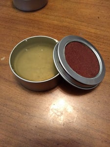

Step 3: Prep the Small Tins
On a quick side note, I want to share how I prepared the small tins.
You will need
2 Small Tins
Leather
Glue
Scissors
1. Take the cap off the tins and trace them on the leather.
2. These tins are from the dollar store and the plastic pieces popped off pretty easily. If they give you some difficulty a hobby knife will help.
3. Cut out the leather circles and glue them on the inside of the lid.
4. Let them dry and the tins are ready for use.

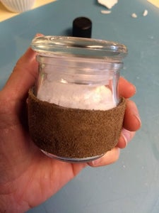

Step 4: Easy Dry Shampoo
Onwards to the dry shampoo. This has to be the most kid-friendly item on the list and it is really super simple.
You will need:
1/8 cup Baking soda
1/8 cup Corn Starch
8-12 drops essential oil (I use peppermint)
Mixing bowl and spoon
Small Glass Bottle
1. Mix dry ingredients together
2. Add essential oils few drops at a time. (Put in a few drops, then stir. Drops then stir)
3. Put powder in your glass bottle
4. Good to go! When Dad’s hair is feeling greasy a simple dusting and combing will have him looking great!
Step 5: The BEST Lotion Bar
Almost done! Whew, lots of instructions in this ONE gift.
But hey….it’s Dad and he deserves a thoughtful homemade gift!
I love love love lotion bars. They don’t make me feel greasy. I feel like I get just the right amount and don’t have more left over sticking to my hands. I love this type in particular because it’s really very simple and absolutely customizable.
You will need:
¼ Cup Shea Butter
¼ Cup Coconut oil
¼ Cup Beeswax Pellets
4-8 Drops of essential oils ( I used Tea Tree)
Microwaveable Glass Bowl
First Small Tin
1. Combine the Shea Butter, Coconut Oil and Beeswax in the glass bowl.
2. Microwave the same way you did the soap. (30 seconds and stir. Repeat until smooth)
3. Add essential oils and stir.
4. Pour into your small tin and let cool.
5. Lotion Bar is done! It smells great. Any dad needs some lotion he can swipe this and apply!
