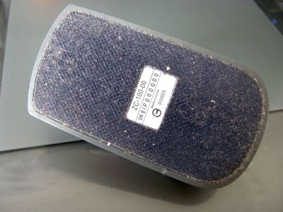

Step 1: Marvel at How Dirty Your Mouse Is and Gather Some Sharps
Locate the bottom of your mouse and be amazed at all the dust it has somehow found.
Then check your inventory of sharp objects: an old multi-blade disposable razor is perfect for the job, but any relatively sharp knife works too (e.g. X-acto knife, Swiss army blade).
And just in case you were wondering, the mouse works through electromagnetic induction.

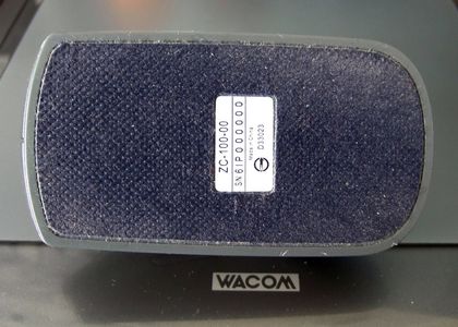

Step 3: ...and a Haircut.
Now the mouse should be a LOT more sightly. You can use an X-acto knife or something pointy and sharp to carefully clean out the junk along the edges of the felt. Once again, don't push down too hard or you'll cut the plastic.
Then, depending on how obsessive-compulsive you are, you should be done with the bottom of your mouse.
