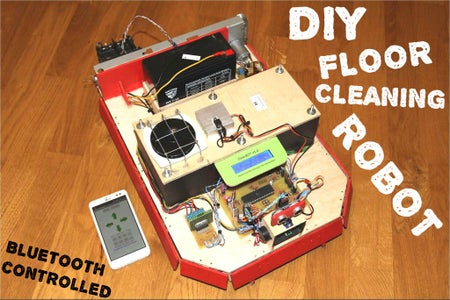

The CleanBOT ( Remote Controlled Autonomous Floor Cleaning Robot) is designed to clean floor in two different ways: with vacuum or active mop. It has auto mode but you can also control it manually by using bluetooth connection and android app.
Most parts of the robot are made from electronics garbage for example:old inkjet printer.This allowed me to significantly reduce the cost of the robot . Current cost of the robot is between 50-60 $ it depends how many parts already you have.

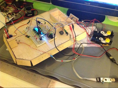

Step 4: Motors
Robot is driven by two high speed DC motors with gears which are from DVD player- they have enough torque to move the robot which weighs about 5kg. I made a separate PCB for motor controller using thermal transfer method. Motor controller is made on L298N dual H-bridge wich can handle up to 2 amps per channel. Using square wave with variable filling generated by the microcontroller i can control speed of the engines .Wheels and axes are made from Lego bricks as y can see in the picture above. In addition, the cooling fan was used to cool down overheating engines. On the front of the robot i used a rotary wheel which allows robot to turn in every direction.

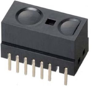

I have used sharp GP2Y0D810Z0F for detection of the stairs . Sharp sensor allows to detect a drop to prevent the robot from falling down the stairs. It is a digital sensor operating in the range of d = 2<-->10cm when the floor is in the sensor field of view (low state is at output) When sensor detects stairs, state on the output will be high. Once stairs are detected, the robot immediately is going back to safe distance and then it will continue to operate.

LCD display is coupled together with a micro controller. On the screen are displayed all important messages for the user. For example when you enable auto mode via Bluetooth display shows the message: "Auto Mode Enabled"
Step 14: Bluetooth & Smartphone App
Bluetooth with a smartphone has been achieved through HC-05 module that allows to comunicate with the microcontroller using serial transmission.
App on smatphone works in the following way: when you press button smartphone send one byte of information (one char)which is received by micro controller . The micro controller also sends the same byte back to the smartphone to check transmission errors. It is possible to: connect to and disconnect from the robot, manual control, enable and disable: auto mode, active mop , blower.
Step 15: Robot Brain
Main PCB is based on an 8-bit micro controller AVR Atmega32 which have its own power supply section . I made this PCB also with thermal transfer method. Program is written in C (GCC) and its completely based on interrupts. To receive and transmit data to Bluetooth i used built in hardware USART. The micro controller is clocked at a frequency of internal resonator 8 Mhz. PWM signal for steering motors and servo is generated by hardware timers. Pulse length of sonar also is measured with a hardware timer. Blower is driven directly from main PCB by Mosfet transistor.
