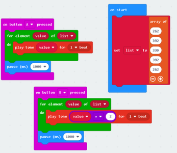

We go to the coding website and take out the following code to download to microbit.
