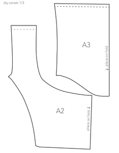

Step 1: Cut Out Fabric
Use a pattern or make a pattern (I modified the pattern from the youtube video above) to cut out fabric
Tips:
- Make sure the pattern is on the fold
- Cut out using some seam allowance

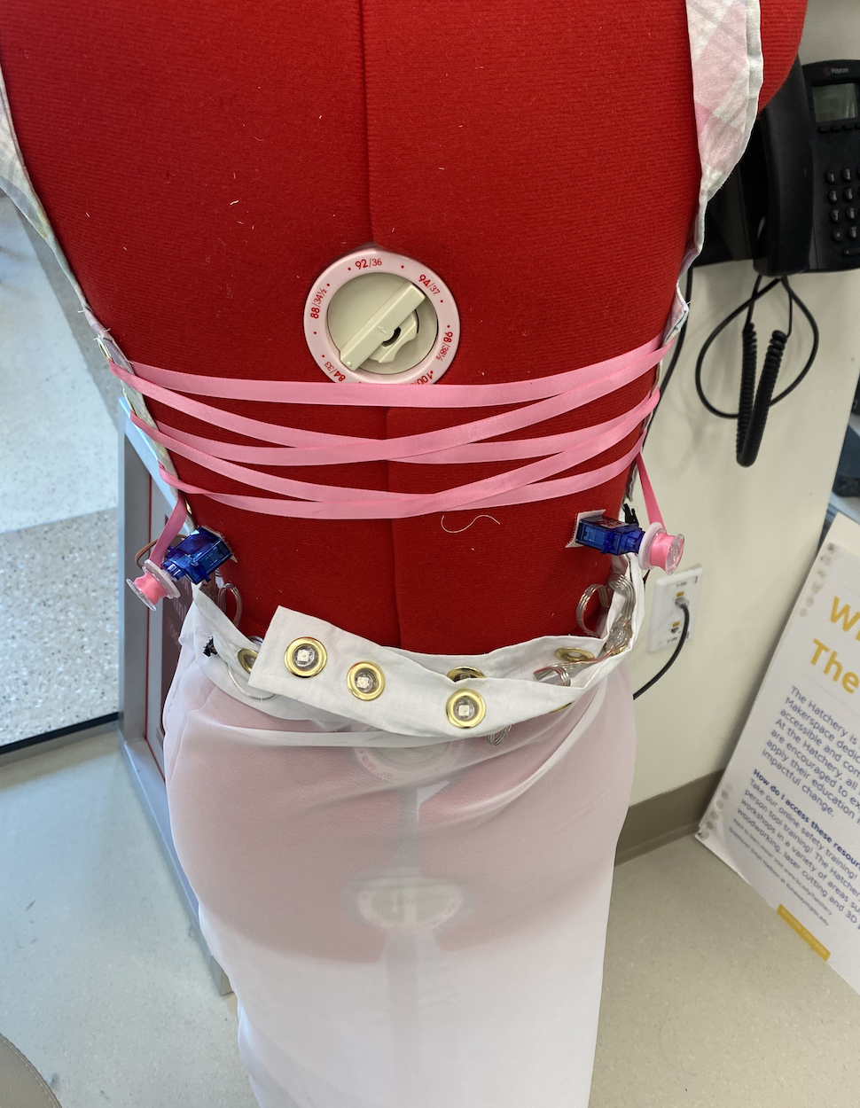

Step 4: Thread Ribbon Through
Just lace it up like a shoelace!

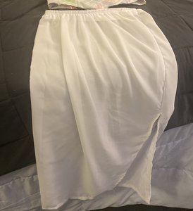

Step 5: Make Skirt
Measure an elastic waist belt to your waist size and sew fabric to it
Tips:
- I measured the material so it went just past my knees
- I hemmed the ends and sewed a slit down one of the sides

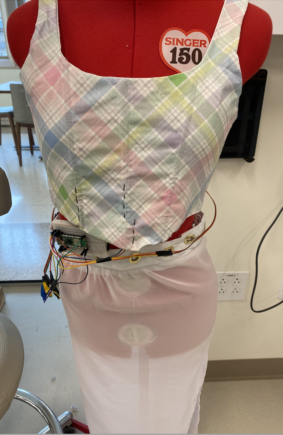

Step 8: Wiring
Wire servos to GP14 and GP15 and wire LED to GP16 (on the Raspberry Pi)
Tips:
- Pico wiring for I2C is power to 3.3v, Blue to GP4 (SDA), Yellow to GP5 (SCL)

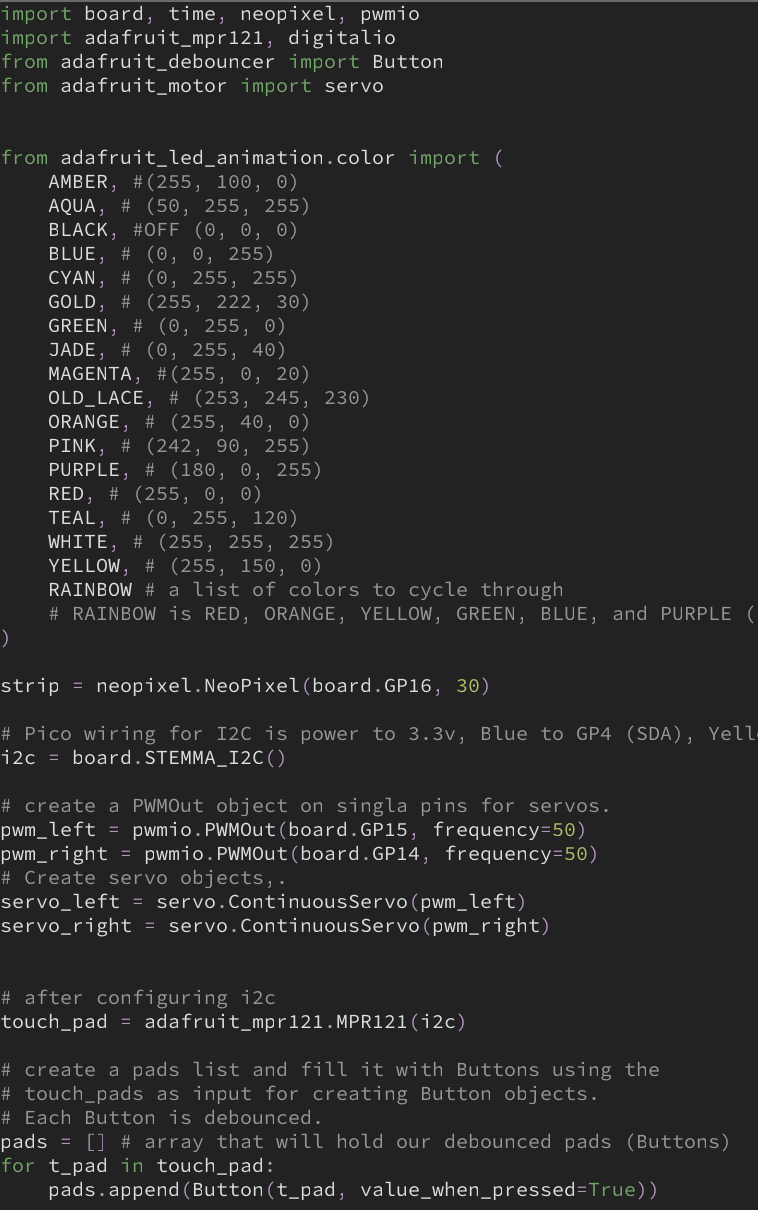

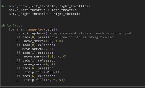

Step 9: Code!
Here's a copy of my code
Step 10: Attach All the Parts
I used a body form as an example of how someone would attach the parts to a person
