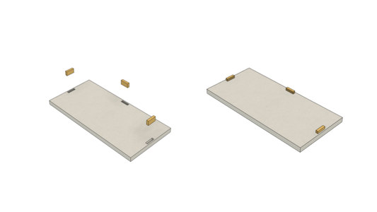

Step 2: Bottom
To connect the body to the bottom...
  1. Grab the 40" x 24.5" x 1.25" (With four 5" x 5" 6.75" at each corner) piece and three splines
  2. Put the three splines inside the 40" x 24.5" x 1.25" (With four 5" x 5" 6.75" at each corner) piece
  3. Connect the piece that was put together with the put-together body
