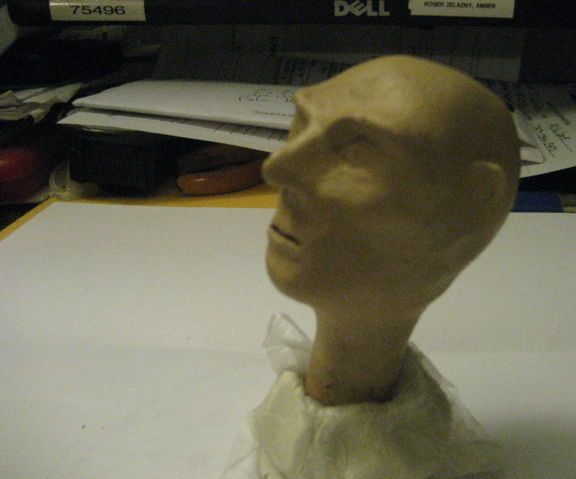

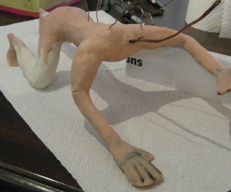

12/19/2015: I added a recent project (sculpted head with built in green eye's)... experimenting with Sculpey modeling compound...found out that LED's and their wiring can survive the rigors of oven firing to set the clay (only 275 degree's for 15 minutes)

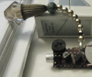

2) Minesweeper 2
this was a follow up project using the same 4017 / 555 combination except that I made a larger chest cavity to fit the circuit board, 4 of the signal lines go down to another 555 timer wired to work as a tone generator, the pulses pass through 3 "early SMD" LED's then into the chips VCC pin. The audio output from the chip go's to a salvaged "piezo" speaker disguised as the sensor coil....
