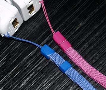

Using some Rit dye, you can customize your Wiimote's straps. I went with Blue and Fuchsia, and at $4 per color, that's not a bad investment.
Step 1: Go to the Store and Get Some Rit Dye.
I figured that dark colors would work best, so if you get yellow, you may be sad with the results. Take your box of dye home, and mix it with 1 cup of boiling water on your stove top. Keep the mixture on the stove, and then stir in your strap(s) (I found that 1-2 straps per bath works the best). Stir it around and make sure you move the plastic on the strap around or you'll get a light spot. When you're happy with the shade, rinse the strap under hot water until it runs clear, then under cold water for a few seconds. Let it dry and you're done!
Step 2: Put the Dry Strap on Your Wiimote.
That's it! Your colored strap can go onto your Wiimote and you're all done!

    GrueHunter
    GrueHunter
    Reply 14 years ago on Introduction
    I'm thinking of getting a refrub Wiimote and trying it. The fuchsia one looks great, but there's a corner on the blue one (you can see in that pic) that isn't the same shade. I don't know why the blue didn't take on that corner. Also, with an entire controller, you may need to double up the dye/water so you can submerge it 100%.

    gillian
    gillian
    It's possible that there was some oil from your hands on that corner acting as a resist to the dye. Next time you could try cleaning the plastic parts with rubbing alcohol before dyeing.
