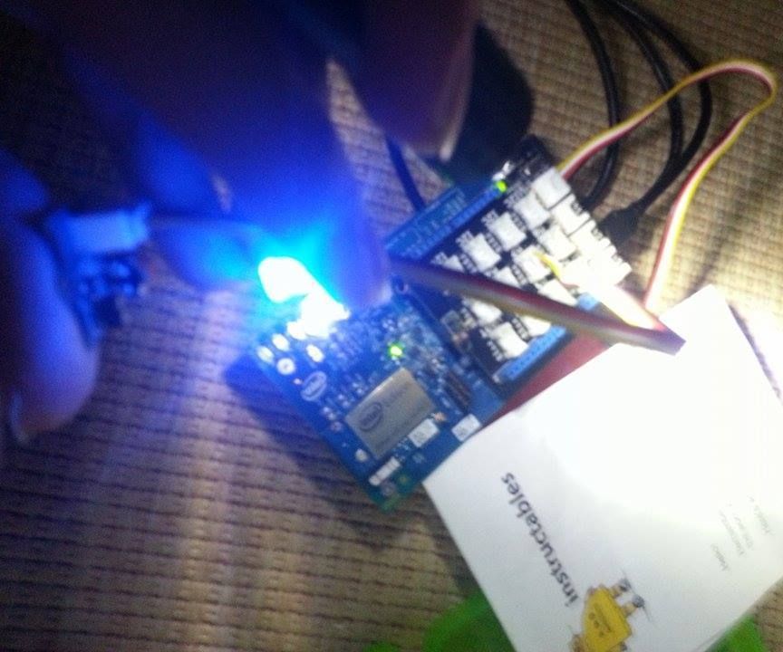

  • Intel edison with expansion board (can use arduino uno too)
  • Grove motor shield (for easier connections and to protect the edison or Arduino Uno)
  • Grove Led (just for testing)
  • Grove Rotary Angle Sensor

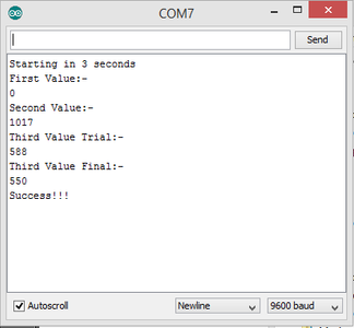

Assuming you have completed Intel edison getting started, attach USB cable to your computer and open Arduino IDE for Intel. Code is in the file attached.
You could play with the code and once you have mastered rotary sensor you can decrease the range of last value. Also you could add more than 3 steps and also change the coding for what to unlock once the code works.
Connections are pretty simple. Attaching LED D7 and rotary sensor to A0 which can also been seen in the photo. above.
