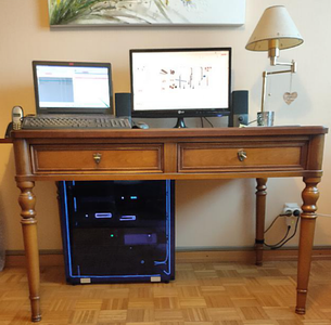

(K) The hardware is arranged on the shelves. To save space and optimise cabling, both switches (LAN and HDMI) are mounted on the underside of the shelf above the servers. All the power supply units are placed jumbled in a basket.
(L) The finished installation shows the distribution of the equipment and the position of the operational cabinet under the desk.

This cabinet meets the need to integrate computer equipment in a small space while taking care of the aesthetics. The installation is sober and functional. The construction is quite simple and does not require any specific tools. The handling of the equipment is facilitated by the removable walls.
