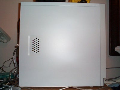

First Step:
-Remove panel and map out where you want windows.
-Take measurements:
4.75" Down from top of case.
1.5" Right from back of case.
3.5" Up from bottom of case.
7.25" Left from front of case
Second Step:
-Turn panel upside down (inward side facing you), now draw the window hole (use the measurements!)
Third Step:
-Carefully clamp panel to work bench (you don't want to dent it).
-Drill a hole in corner of window location
Fourth Step:
-Cut out lines with a jigsaw (you could also use side cutters / tin snips)
Fifth Step:
-Sand down sharp edges and make sure cuts are relatively straight (if you want a rectangle)

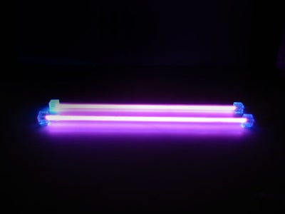

Lighting!
Very easy, buy your Cathode lights and install within the case, simple!
Now the on/off switch for the light...
The light come with an on/off switch, well your going to have to take the front of the case off.
Measure where you want the switch to be... and draw a circle.
Drill the hole out and sand it down (normal sand paper works fine)
Dismantle switch, pull wires through, and attach the switch (most switches just clip into hole).
Turn off house lights and turn on the these babies! UV Cathodes will make your ordinary motherboard glow!
