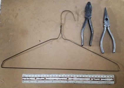

What you need:
1 coat hanger from the dry cleaners
A large pair of pliers
A smaller needle nose pliers
A ruler and marking pen

1. Grab that coat hanger, snip off the hook and straighten it outl; turning it into a straight piece of wire.

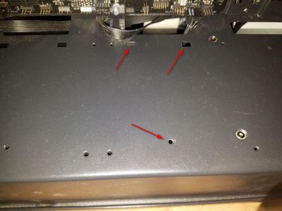

2.Take a look inside your computer case, and scout out some unused holes. Imagine how you can fashion wire legs to support the back of your GPU card using these holes as anchor points. Be sure your design guarantees the brace will not fall over in any direction or can move into any of the electronics. The anchors are very important. Take your time and get that design just right! The design work is where most of project time is spent!

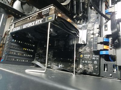

4. Put the brace into place. You'll be surprised by how sturdy a simple coat hanger can be – it can easily handle the weight of your GPU card. Now that the brace fits; you can remove it and paint it black. It will all but disappear when in the computer case when reinstalled.

Each computer case is different and you will need to design a brace that fits your computer case.

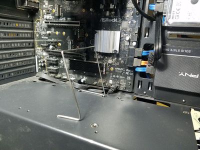

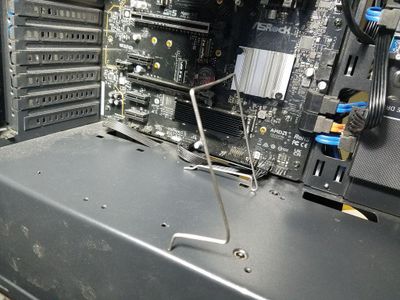

For example, my computer case has a power supply cover. I repurposed three unused holes in the cover as anchor points for the GPU brace. Tension from the legs keeps the anchors in place and makes the GPU brace unable to slip out of position. Slight bending of the legs can adjust the brace to a perfect fit..
