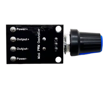

  4. Rotary encoder sensor (speed control module)

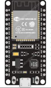

  5. ESP8266 Wi-Fi module NodeMCU

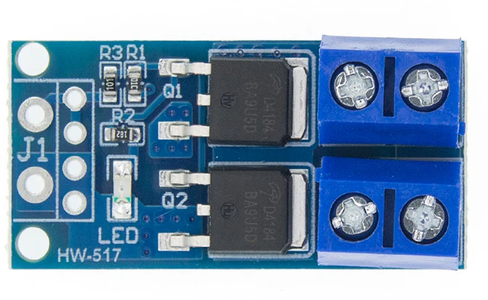

  6. 15A 400W MOSFET trigger switch (PWM regulator)

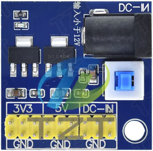

  7. DC-DC step-down converter 12V to 3.3V/5V for Arduino

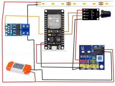

Step 2: Wiring and Installation
I routed the cables and stuck the LED strip to the profile. I bolted a cap in the center of the light fixture and used it to connect the other profile. This made the connection easy to repair if needed.
I made something like a splitter from an old computer cable. One end plugs into the monitor, and the other connects to the monitor's power cable. From this connection, I take 220V to power the LED strip and the ESP32.
Step 3:
Connecting the control system.
  1. I took a 12V power supply from the LED strip adapter.
  2. I reduced the voltage to 5V through a DC-DC module (12V to 3.3V/5V) and powered the ESP32.
  3. I powered the Rotary encoder sensor and the MOSFET Trigger through the same DC-DC module (12V to 3.3V/5V).
  4. I interrupted only the negative wire going to the LED strip power supply using the MOSFET Trigger, as it only cuts the negative. The control is connected to GPIO27 on the ESP32.
  5. I connected the positive and negative of the Rotary encoder sensor to the ESP32 at GPIO17 and GPIO16 respectively. If these are swapped, it’s not a problem – it will just increase/decrease in the opposite direction.
