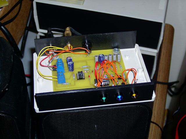

    I built a digital color organ beat detector by creating two RC integrators per channel, with the time constant of each integrator set slightly longer than the other. These two "average" signals were fed to a comparator. The audio level charges the longer RC integrator to a more average level than the RCI with the shorter RCI, allowing peaks and changes in the signal to trip the comparator. It works like a champ for any kind of music.

    Using a laptop to control lights is a tad silly. an LM3915n chip will do the EXACT same, without needing a laptop, or dirivers, or winamp lugin or anything. and it's easy as heck to wire up. you can route the 3.5mm jack into the chip, and then connect the relays to turn the lights on/off into the output pins of the chip. lots of free tutorials on how to do it via google.

    The plugin does beat detection using finite difference on a window of frequencies in the FFT. The effect didn't look good when it synced the lights only to the audio level. I'm not smart enough to figure out a way to do beat detection without a computer. Post an instructable to show me how!
