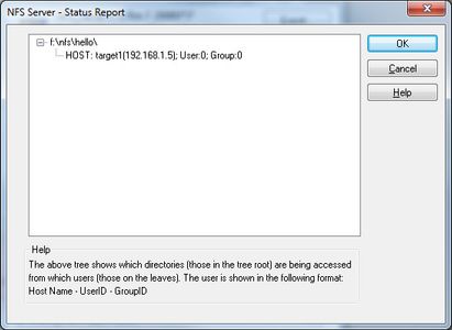

Step 3: Host Computer Setup : NFS Share
This is the part that is most crucial; I spend quite some time trying to get the STB to recognise and parse the Locator files without success until I figure this part out....
Before you begin, it is good to test that the host computer can ping the Set Top Box.
Do this by opening up a command prompt window and type ping IP address of STB
For me, it is ping 192.168.1.5
You should see the responses from the STB.
1. NFS
Windows does not support NFS natively; at least not Vista. I read that Windows XP does have a free NFS component but it is turned off by default. Do a search on NFS on Windows XP if you are using XP.
In order to create NFS shares, I download a software call nfsAxe from
http://www.labf.com/nfsaxe/index.html
2. Create the Export (see picture)
After installing the software, you must create a NFS share that mirrors the setting entered in the STB.
Click 'Add Directory' and point it to the location where you keep the locator file and the xlet classes.
For more information on locator file, please refer to the ADK documentaiton.
In my case, the directory is F:\nfs\hello\
the export mount path will be /f/nfs/hello
this matches the setting in the STP 192.168.1.111:/f/nfs/hello
Next, you must Add User Access
Create a all hosts, all users, all groups, R/W access for this export.
3. Name Conversion (*VERY IMPORTANT)
Change the Mode to 'Allow illegal chars' and
check 'Use UTF8 Name format'
Move on to the next step

Step 4: Test and Start Development!
The last step before setiing up your software development involves testing that the STB is able to run the xlet in the host computer.
1. Using the remote control, select 'Start Xlet' from the Main Menu of the STB.
2. The STB will try to locate and parse the Locator file in your host computer based on the settings stored in the STB network configuration.
3. If successful,
- in the NFS server, you will see the STB IP address mount (see picture)
- in the STB, you will see the 'Start Xlet' menu and any locator file.
- at the same time, you will see all the debugging information on the serial terminal
4. Run the Xlet!!
If step 3 above is successful, you can now select the xlet and run it.
In my case, the xlet locator file is call 'start'
Select it and press 'Enter' on the remote control
5. Xlet running (see picture)
6. To stop the xlet, press 'NAV' on the remote.
7. Well, that's all and you can now start to create your software development environment using your favourite IDE such as Eclipse.
