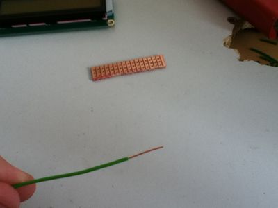

We now need to solder the display to strip board and attach wires to it,
first get the display and the strip board,
insert the display into the end of the strip board, ( Look at image )
When inserted, you then need to decide where you are going to put wires and mark the strip board at that length, ( look at image )
When you have decided where you are going to cut the strip board, you have 3 ways of cutting it,

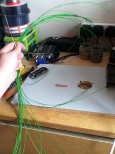

first cut your wire, i done mine 1.2m each length,
I needed 16x wire
so overall i needed 19.2m of wire, i have enough as i just brought 18x 100m rolls of eBay ahaha

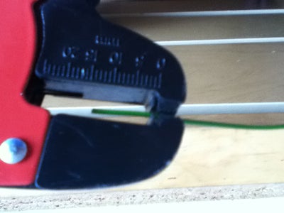

cut your wire and strip both ends of every piece,

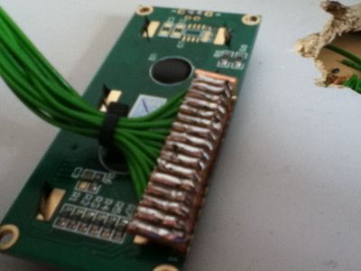

on one end you need to cut off a 3cm piece of electrical tape and put it on the 1 end of the wire then fold over to sick it together,
you then need to label it, e.g first pin is VSS so on the tape you write VSS,
do this step for ALL wires, so all 16 cables are labeled at the one end,
now on the opp end of the cable, you need to insert it into the strip board, then bend the copper so it is flat on the underside of the board,
you then solder all of them MAKING SURE NONE OF THEM TOUCH AT ALL !
look at pictures if you don't understand :),
then when ALL wires are soldered IN ORDER on the strip board, you need to plug it onto the LCD display ensuring that the pins match up with how you have soldered it, then solder it to the display,
look at pictures for more understanding :)

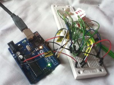

Now we need to connect the lcd display to the arduino, i chose to use a breadboard to do this but if you want to, you can connect straight to arduino, ill explain why i chose the breadboard method in the lat step :)
Make the following connections
with Pin 1 being VSS on display :
Pin 1 to Arduino GND
Pin 2 to Arduino 5V
Pin 3 to wiper ( this is the middle pin of the 10k potentiometer )
Pin 4 to Arduino pin 12
Pin 5 to Arduino GND
Pin 6 to Arduino pin 11
Pin 11 to Arduino pin 5
Pin 12 to Arduino pin 4
Pin 13 to Arduino pin 3
Pin 14 to Arduino pin 2
Because we will only be writing, pin 5 will be dropped to ground to show that there will be no reading. For those who wish to use the backlight, connect LCD pin 16 to GND and LCD pin 15 to +4.2V.
Connect one side of the potentiometer to Arduino GND, the opposite to Arduino 5v, and the center to LCD pin 3. Now you're in business.

Step 9: MY ADDED EXTRAS :)
THE reason that i used the breadboard was becuase i want to add multiple displays to display the same writing,
one for inside the room and one for outside the room,
so i used the breadboard to bring cables from the arduino the the board,
then i connected the wires from the 1st lcd display
and you will notice that a breadboard has 5 holes in a collum, so that allows me to connect 4 lcd displays,
if you want more than 4 for some reason then just do some jumpers from the 5th holes to another part of the breadboard
and connect your other displays :),
look at the pictures for an example,
*** NOTE : I ALSO MOUNTED IT IN A PROJECT BOX WITH CABLE TIES AND I CUT THE HOLE WITH A KNIFE,
IT IS AN EXTREEMLY BAD ATTEMPT BUT IT IS A PROTOTYPE NOT THE FINAL PRODUCT,
THAT WAS JUST TO SEE WHAT IT WOULD LOOK LIKE ***
and thanks for reading, hope this helped :)
