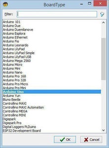

Step 3: Start Visuino, and Select the Arduino UNO Board Type
The Visuino: https://www.visuino.eu also needs to be installed. Download Free version or register for a Free Trial.
Start Visuino as shown in the first picture Click on the "Tools" button on the Arduino component (Picture 1) in Visuino When the dialog appears, select "Arduino UNO" as shown on Picture 2

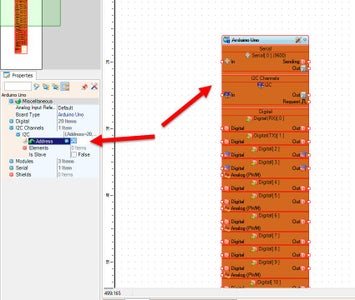

Step 4: For Master Arduino - in Visuino Add, Set & Connect Components
First Click on the Arduino Board and in the properties select "I2C Channels > I2C " and set "Address" to 20 (See Picture1)

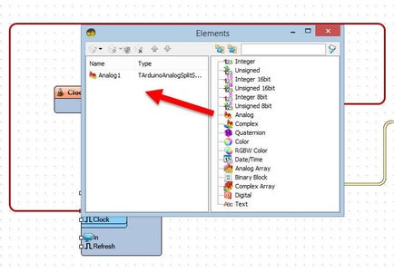

  • Double Click on the "SplitStructure1" and in the "Elements" Window drag "Analog" to the left side (See Picture6)
  • Close the "Elements" window

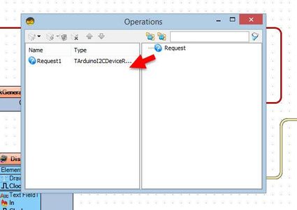

  • Double click on the "I2CDevice1" and in the "Operations" window drag "Request" to the left side (See Picture8)
    In the Properties window set Size to 4 (See Picture9)
  • Close the "Operations" window

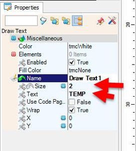

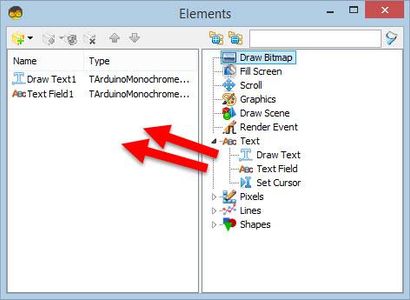

  • Double Click on the "DisplayOLED1" and in the "Elements" Window
  • drag "Draw Text" to the left side (See Picture10)
  • In the Properties window set size to 2 and Text to TEMP (See Picture11)

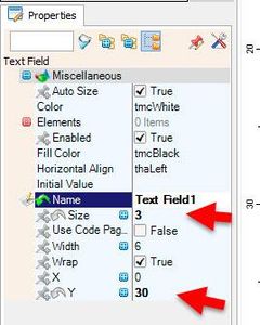

  • drag "Text Field" to the left side (See Picture10)
  • In the Properties window set size to 3 and Y to 30 (See Picture12)

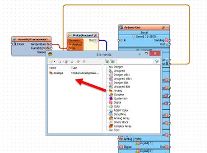

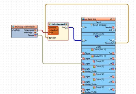

Step 5: For Slave Arduino - in Visuino Add, Set & Connect Components

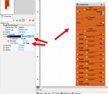

First Click on the Arduino Board and in the properties select "I2C Channels > I2C " and set "Address" to 20 and set "Is Slave" to True (See Picture1)
  • Add "DHT11" component (See Picture2)
  • Add "Make Structure" component (See Picture3)
  • Double Click on the "MakeStructure1" and in the "Elements" Window drag "Analog" to the left side (See Picture4)
  • Connect "HumidityThermometer1" pin [Temperature] to "MakeStructure1 Analog1" Pin [In]
  • Connect "HumidityThermometer1" pin [Sensor] to Arduino board Digital pin [2]
  • Connect Arduino board I2C pin [Request] to "MakeStructure1" pin [Clock]
  • Connect "MakeStructure1" pin [Out] to Arduino board I2C pin [In]
Upload the Project to the Arduino Board (see the Generate, Compile, and Upload the Arduino Code step)
