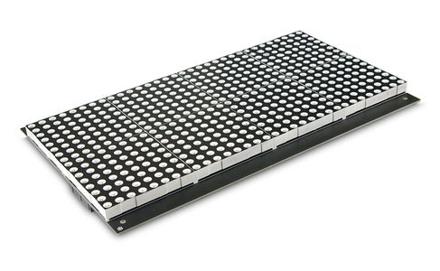

  • 1x Led Matrix HC1632c (On the diagrams the LED matrix is only represented by its connector)

The wiring is probably not the hardest part of this instructable. All you have to do is to plug the ethernet shield on the arduino and then, the LED matrix to the ethernet shield using the wires.
Note that the pins on which you connect the HT1632c Led matrix are not really important as long as it is coherent with the arduino code that you will write in the next step.

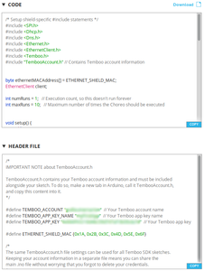

Step 4: Get the Code From Temboo
As it was explained in the previous step, Temboo automatically generates a code for your arduino. So, the first thing you'll need to do is to copy/paste this code in two files :
  1. Open the arduino software
  2. Copy the code located into the "Code" box of Temboo and paste it into a new Arduino project
  3. Create a new tab in Arduino and name it "TembooAccount.h"
  4. Copy the code located in the "Header" box
  5. Save everything
  6. Check the code
  7. If you don't have any errors in your code, you can upload it to the arduino.
Once you have uploaded the code given by Temboo on your arduino, check if it works correctly with the serial monitor. It can helps to detect connectivity problem with your local network or with your ethernet shield. Do not hesitate to copy/paste the error log in google to find if someone had the same problem.
