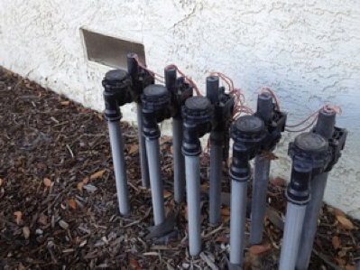

Valves that control the water flow in your yard are opened and closed using solenoids. Apply 24VAC to the valve and it will open and the water will flow; remove the voltage and the valve will close. The controllers on the other hand, are complicated because they need to include clocks and timers for each valve, settings for days of the weeks, buttons for testing each valve, and hard-to-read displays. What is great about creating your own Afero Sprinkler Controller is that it can be done with a standard Afero Modulo unit and less than $20 of easily-available parts. The timing controls are sent by the Afero Cloud, and everything is managed from your phone.

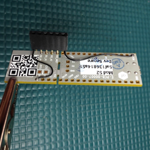

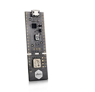

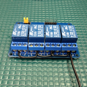

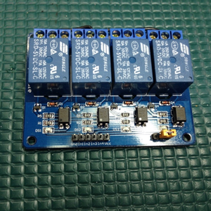

The first part of this project is to pass the GPIO signals from the Modulo to the four Relays that control the sprinkler valves. In the top image, you can see the relay board, and the 2nd image is a close-up of the six-pin connector. The connector has ground (Gnd) on the left, the four signals, and the 5V Vcc pin on the right.

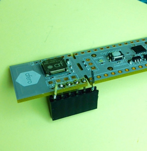

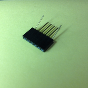

The 3rd image shows four GPIO pins on the Modulo, labeled IO0 through IO3. I want to connect the Modulo IO pins to the Relay’s Input pins so I will use a Shield Stacking Header, but instead of just the four pins, I’m using a six-pin header, and bending the VCC and GND lines out so they can be used to apply power to both the Modulo and Relay.

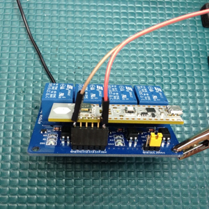

Solder the Stacking header to the 4 GPIO lines on the Modulo; you may want to use a ‘helping hands’ to hold the header straight while soldering. If the connector isn’t straight, you can heat up each of the solder connections and gently adjust the connector, but it is better to get this right from the start. When you are done, you can test the fit by plugging the Modulo into the relay board.
Step 6: The Modulo Squad Or, Old Solders Never Die, They Just Fade Away
Next, we will want to connect the two bent header pins to the Ground (GND) and 5V (VIN) through-holes on the Modulo board. The GND pin is just opposite the GPIO0 (I00_A0) pin on the Modulo, the 5VCD Input is the very top pin on the same side as the header. I used a fine piece of insulated wire for this. Just be sure to connect the GND and 5V wires to the pins that match the connector on the Relay.

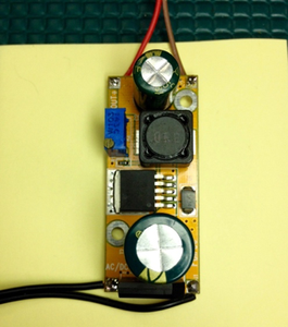

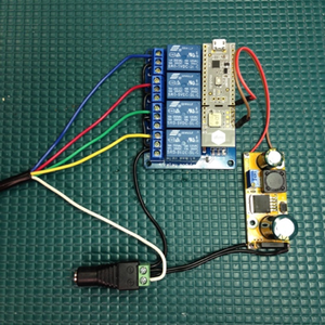

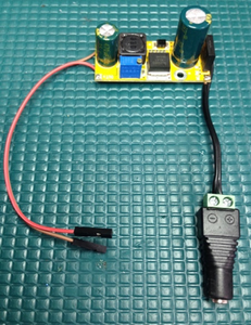

Now that your Modulo and Relay boards are connected via the Shield Stacking Header, it is time to apply some power. For this, I found an inexpensive AC/DC to DC Buck Converter on eBay ($2.80). Remember that the Sprinkler Valves want 24VAC, and the Modulo and Relay wants 5VDC. Having a single 24VAC power supply supplying power to both is convenient, but we need to convert the AC to DC, and drop the voltage. The Buck Converter is small and useful for a variety of projects, and with the twist of a screw you can easily adjust the output voltage.

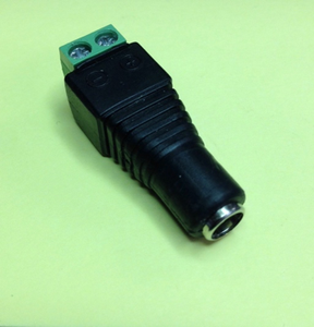

Start by soldering wires to the AC/DC input through-holes on the Buck Converter (bottom wires in the top photo). Strip the ends of these wires and connect one to each terminal on the Barrel Jack Converter. Since the power supply provides AC voltage, it doesn't matter which wire goes to which connector. Next, add jumpers to the output side on the top. These will slip onto the GND and Vcc pins that stick up from your Modulo board - but don't connect them yet!.

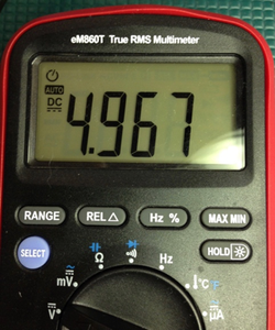

Now you will want to check and adjust the voltage on the Buck Converter. Start by connecting your voltmeter to the output pins and set the dial for DC Volts. Now plug the AC converter into the wall and plug the connector into the Barrel Jack Connector. While watching the voltage, adjust the small screw on the blue trimming potentiometer until the output is five volts. You are now ready for the final assembly.
Step 8: We Came in Pieces!
You now have all of the key pieces for assembling your new Sprinkler Controller. Before we complete the final wiring, let’s apply power to the system and verify that the main relay is working. Slide the Modulo onto the Relay connector, attach the power (Ground to Ground, ‘+’ to Vcc), and when power is applied, the Modulo should initialize and you should hear the first relay click. You can even get out your phone and launch the Afero mobile app and select the Modulo. When you turn the LED off and on, the first relay should toggle off and on as well. To control all four relays, we will need to create a new Profile, and that will be in just a few more steps.

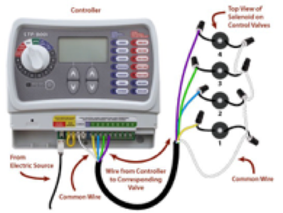

Step 9: Interlude: Let’s Look at How Sprinkler Valves Work

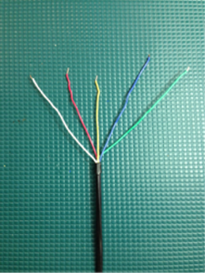

Look at the wire bundle coming from your sprinkler valves. One of these wires (white in our example) is connected to all of the valves. This wire is called Common since it is Common to all of the valves. This is not to be mistaken for the Relay Common point. Instead this Common will connect to one side of the 24vac power supply. Each of the remaining wires connects directly to one of the four valves. In our case, connecting one lead of the 24vac power supply to the common White wire, and the other to the Red wire, will cause the first sprinkler valve to turn on. Connecting the power to the White and Yellow lead will turn on your second set of sprinklers. You should test that each valve is working properly before going any further.
Step 10: Relay Race to the Finish!
We’re almost done! Now we need to do some wiring for the relays. Remember that the Sprinkler Valves are turned on with 24VAC. A four-sprinkler watering system only requires five wires since one of these wires is common (white) and shared by all of the valves and each of the other colored wires is dedicated to a particular valve. In the top image you can see the white common wire connects directly to one side of the power on the Barrel Jack.
The other source for power for each valve comes from the other side of the barrel connector. This black wire connects to the center/common pin on the first relay. Short jumper wires (see 2nd photo) carry this voltage to the center/common connectors on the other three relays. Now all that is left is to feed each of the colored sprinkler lines to the NO (Normally Open) lines on the relays. When a relay closes, the connected valve will have both the White Common and the Black 24VAC power.

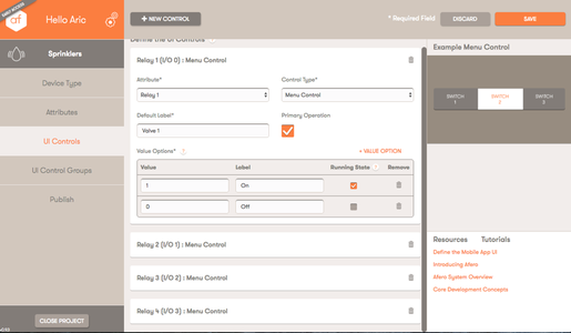

Step 14: APE: UI Controls
Click the UI Controls navigation tab and click + New Control. Select the Menu Control then click Add. Under the Attribute, select Relay 1, and give it a name (VALVE 1). Create the first value option as Value:0 and Label: Off. Then click + Value Option to add the second state of Value:1 and Label On.
Repeat the previous steps to create the additional three valve controls. Once all four controls are created, click Save.

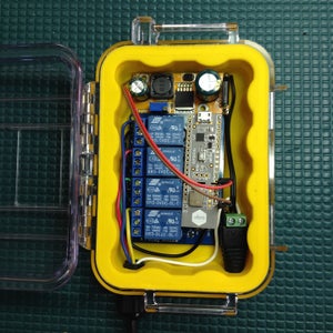

The final touch is to put your project inside a waterproof container. I found that a Pelican 1010 case fit everything very nicely. While not necessary, I added a PG7 black plastic waterproof Cable Gland. Once you have moved all of your Sprinkler Valve wires from your old controller to your new wireless controller, apply power and be prepared to take a stroll through your new Smart Garden. Standing by your rose bed and turning on the sprinklers from your phone is incredibly satisfying.
Until the next time, happy watering!
