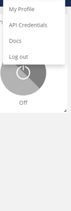

  • Next, insert your Ubidots token here. Follow the below steps to find your unique token.
  1. Select your profile
  2. Select "API Credentials"
  3. Under Token, copy the "default token"
#define TOKEN ""
