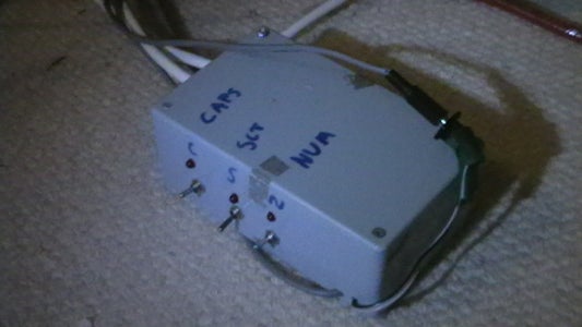

this is a device that turns lights (or what ever) on with the push of the caps num or scroll lock
if you want you can use an xbox DVD remote with your computer and turn on your lights with that. so you can walk in to the room and push a button on the remote and the lights turn on

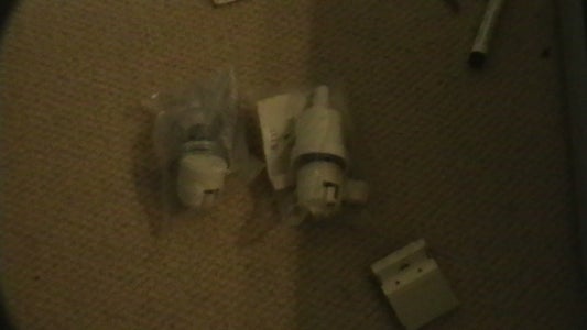

parts:
3 transistor BD140
3 capacitors 10-60uf
3 resistors (so the LEDs don't burn out. unfortunately I forgot there value)
3 relays (the ones with 5 legs)
3 switches (single pole double throw) 240v (120 in the US)
1 (single pole single throw) switch 240v (120 in the US)
a box
wire
4 grommets
A keyboard with num caps and scroll lock lights
3 LEDs
7 (or more) meter extension lead
2 power sockets (see picture)

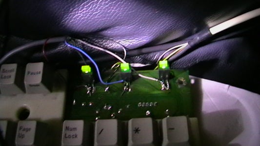

Step 2: Opening (and Modding) the Keyboard
Crack open your keyboard and remove the circuit board (mine had a zillion screws holding it in)
then locate the lights and solder the wires to the legs of the LEDs (see picture)
when done put the keyboard back together. you may need to cut a hole for the new wire to get out
important note: not all keyboards work with this

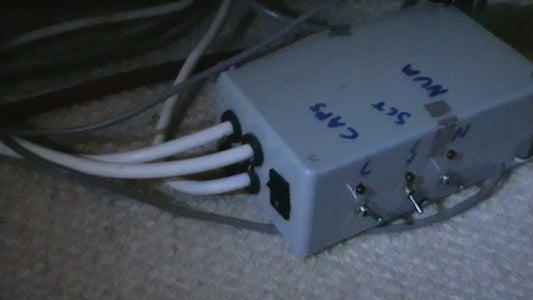

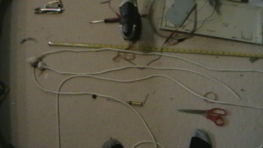

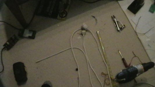

Step 3: Prepare the Cord and Box
cut the extension lead into 4 equal parts

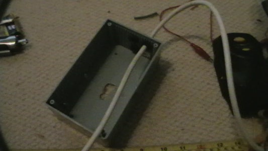

drill 4 holes into the side of the box
shove the grommets in to the holes
tread the cords trough the grommets (spit helps)
strip the wires (the end thats in the box)

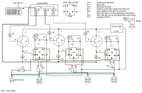

Step 5: Electronic Bits
now this is the most fiddley bit, putting the circuitry together.
I was too lazy to make a PCB so i soldered wires to the components
Step 6: Put Every Thing in the Box
you need to cut some holes for the switches, wires and lights
make sure all the wires in the box a insulated

Once you have put every thing in the box and it looks like the picture above than you can now start to test it.
plug a lamp (or something) into one of the sockets and plug the keyboard into the computer
then plug the power in and turn on your computer if nothing explodes, good.
now the lamp should flash as the computer boot (this is normal)
when the computer is done push the caps num and scroll lock buttons, an led should light up for each button.
if it doesn't than open it (unplug it first) and check all connections.
if all the lights turn on when you only press one button, than check the connections if that doesn't help than it may be the keyboard, not all keyboards work with this

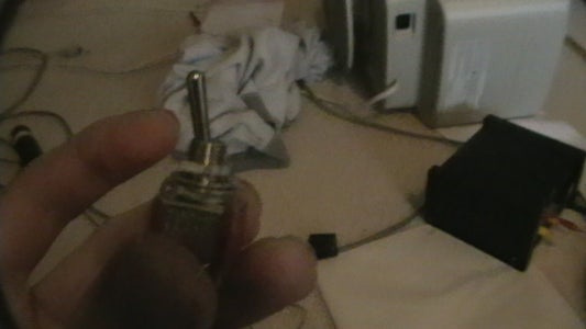

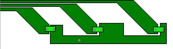

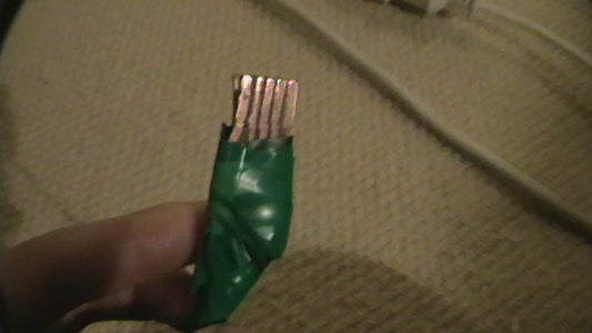

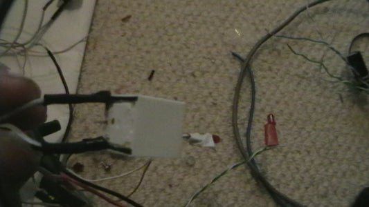

Step 8: Optinal Stuff

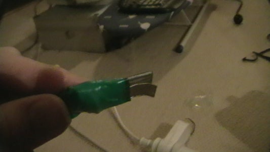

if you want you can use your xbox DVD remote, you will need a USB cable and a piece of circuit board and etch it (theres lots of instructables on how to do this) , then cut so it fits into the plug on the DVD remote sensor
its hard to explain so just look at the pics

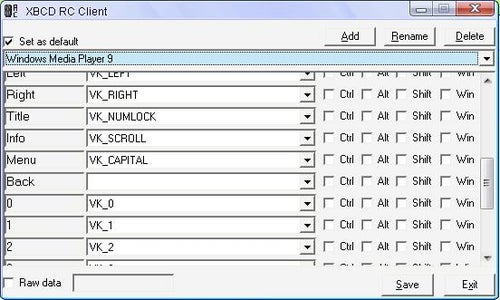

Step 9: Software for the DVD Remote
you need software to run the xbox DVD remote:
XBCDRC
once you have installed the software, plug the sensor into the USB port, it should say it found new hardware. if it says "USB device not recognizing" than try moving the connection.
once the hardware is installed run XBCDRC (should be in start menu)
then choose what buttons control num caps and scrol locks
(this picture was taken on an XP computer)

the switches on the front are wired in a double switch so you can manually turn on or off the lights
the single pole single throw switch is to disable the lights.

    relay
    relay
    Reply 12 years ago on Introduction
    I used mechanical relays for 2 reasons 1 I had some at the time 2. the mecanical ones have the normally open and normally closed, so theres a double switch. so you can manual turn the lights on or off, and the computer can do the same
    0
    wi-fi astronomer
    wi-fi astronomer
    When you use an old fashioned relay, you need a transistor first. Way easier to use a solid state relay that takes a control voltage of 5 volts. They also have the desired isolation of the house current from the printer fitting. See my comments above!
    0
    relay
    relay
    but it doesn't use a printer fitting, Iv got another controller for the printer plug but I think i Brock it (I put the power in the wrong way) the point of this instructable is to demonstrate that you don't have to use the printer port, and that one can use a USB keyboard. also i said above that the mechanical relays have a normally open and normally closed. hears a little GIF explaining the need for mechanical relays.
