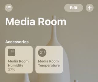

Step 6: Try It Out
Restart HomeBridge, and you should now see a new accessory called Fireplace, that uses the FAN icon. You should be turn on, off and control the flame height with the Home app. Please note that when the fireplace is busy turning on or off, additional commands will be ignored and the Home app will show an error.
