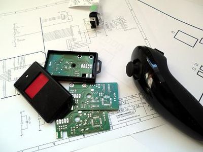

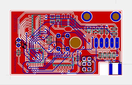

A main feature of the Wii Remote is its motion sensing capability, which allows the user to interact with and manipulate items on screen.
It was the goal of this project to bring a small piece of this awesome idea in the world of NES (Nintendo Entertainment System) and SNES (Super Nintendo Entertainment System). We use an AVR micrcontroller to transform the signals from the Nunchuk to the NES or SNES.
Operation modes:
Mode 1 - game pad emulation with acceleration sensors: the interface emulates the funtionality of a standard SNES game pad. You can simulate the function of the direction keys by swinging the Nunchuk to left, right, forward and backwards. The both buttons of the Nunchuk emulate button A and B of the SNES game pad. The little joystick on the top of the Nunchuck will emulate the button START (up), SELECT (down), shoulder LEFT (left) and shoulder RIGHT (right).
The LED of the interface is allways on in this operation mode. Use this operation mode for all SNES games without mouse support. Also availabe for NES.
Mode 2 - game pad emulation with joystick: the interface emulates the funtionality of a standard SNES game pad. You can simulate the function of the direction keys by swinging the joystick at the top of the Nunchuk to left, right, forward and backwards. The both buttons of the Nunchuk emulate button A and B of the SNES game pad.
The LED of the interface is switch off shortly all 2 sec in this operation mode. Use this operation mode for all SNES games without mouse support. Also availabe for NES.
Mode 3 - mouse emulation with acceleration sensors: In this operation mode the interface will emulate a SNES mouse. You can move the mouse pointer on the screen by swinging the Nunchuk to left, right, forward and backward. The both buttons of the nunchuck have the same functionality as the mouse buttons. The LED of the interface will blink with (ca. 1Hz) in this operation mode.
Mode 4 - mouse emulation with joystick: In this operation mode the interface will emulate a SNES mouse by using the joystick in the top of the Nunchuk. The both buttons of the nunchuck have the same functionality as the mouse buttons. The LED of the interface will blink with (ca. <0.5Hz) in this operation mode.
You have to switch the operation mode by pressing the PROG button of the interface and hold the button for more as 1 sec. The interface will change the operation mode after releasing the PROG button. The actual operation mode is shown by the LED (see above).
