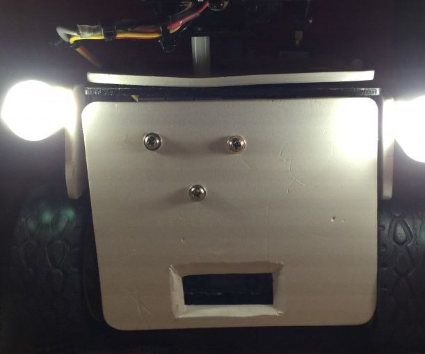

Thanks for the post. I made this circuit and it worked well. The photo was taken before I found the error on only hooking the unregulated power to one pin.
