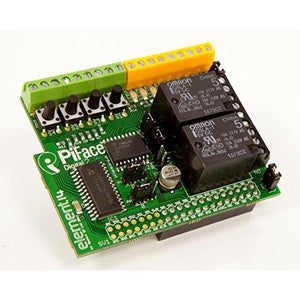

Step 2: PiFace Digital
Then get a PiFace Digital board (BEWARE to buy the one for Pi2: here at Amazon) and plug in on the Raspberry Pi.

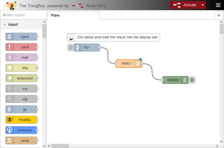

Here is the basic editor.

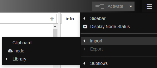

Step 6: Import the Piface Plugin
Select "Import - Node" from the right menu

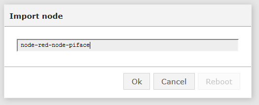

Step 7:
Fill carefully with the plugin name.
Hit Ok and wait the reboot button to become activ, then use it to reboot the Pi.
Step 8:
Refresh your browser.
Now enter "piface" in the filter box to find the new nodes.
Step 9:
Drag the first one (with the handle right) to the workspace.
Step 10:
Add also a display node from the palette and link the PiFace node to the display node.

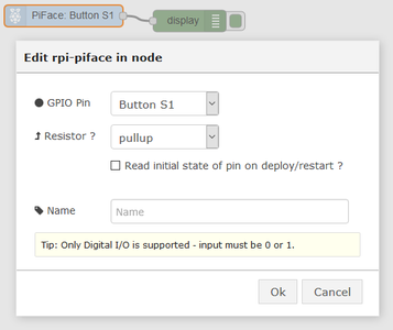

Now we have to choose from where to get the information:
Step 11:
Fill the setting dialog as shown.
Now use the activate button to make the flow activ:

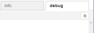

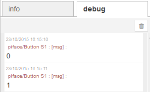

Select now the "Display / Debug" tab on the left, if not already in front:
Step 13:
Now press the first physical button on the board and let it pressed: a 0 is displayed.
Now release it: a 1 is displayed:

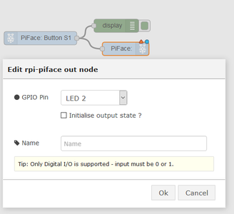

Step 15: Turn on a LED
As the board contains LEDs, we can turn them on.
Use now the second PiFace node to build the following flow, using the previous node:
Step 16:
Double clic it, fill the dialog as above and then activate.
Step 17:
Now when you press the physical button, the LED turns off, when you release, it turns on.
