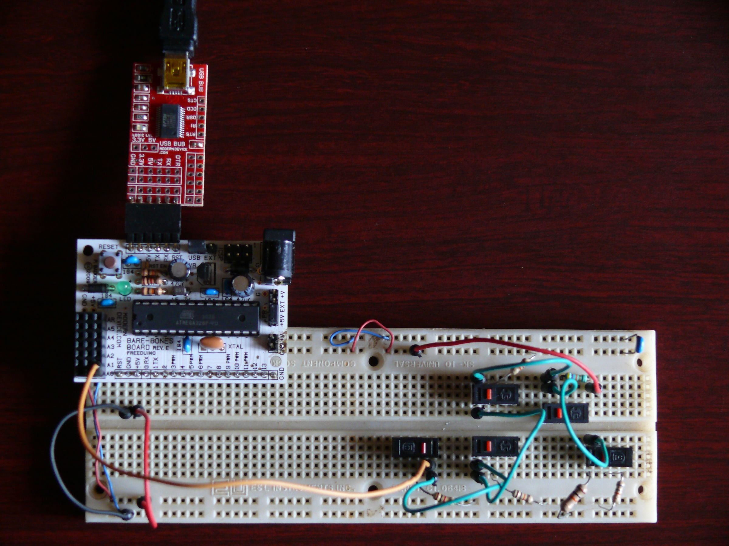

Introduction: Controlling 20 Led's From 5 Arduino Pins Using Charlieplexing
Today, I'll show you how to control 20 LED's from just 5 Arduino pins. I'm working on a project where I need to control 15 LED's, 3 buttons, 3 seven segment displays and an RGB orb from one Arduino. Now if you work it out, you would see that without some clever multiplexing, I would need 15 Digital outputs for the LED's, 3 inputs for the buttons, 21 digital outputs for the seven segment displays and 3 PWM outputs for the RGB orb.
My Arduino doesn't have 40(15+21+3) outputs and 3 inputs, so I either need to drop features (Which doesn't sound like the fun thing to do), buy an Arduino Mega (Where's the fun in that) or I need to find a clever way to make it work. While I'm usually lazy, doing the impossible sounds like a lot more fun (Ok, the improbable then...)
I've already managed to hook 5 buttons to one analog input and documented that here:
https://www.instructables.com/id/How-to-access-5-buttons-through-1-Arduino-input/
By using Charlieplexing, you can hook up n*(n-1) LED's to n microcontroller pins. I'll go through the theory in the next step, but from this you can see that I can hook up 20 LED's on 5 pins or 12 LED's on 4 pins, which would be a great start for actually making this all work on 1 Arduino.
If you search Instructables (and Google for that matter), You'll find lots of theoretical explanations of how Charlieplexing work, and you'll even find some examples of Charlieplexed LED's running on Arduino's. The problem is that the code on these examples are generally not explained very well, and are usually very tightly tied to the exact hardware setup that the author used. This makes it an exercise in futility and frustration to try and make it work on your own projects.
I will show you exactly how this works, how to set it up with as many LED's as you would like in as painless a manner as possible (Although it gets horribly complicated if you go to more than about 30 LED's), how to code it so it works for you, and which problems I had to overcome in the process.

Step 3: The First Problem - Wiring It Properly
I don't joke when I say this is not as simple as it seems. If you make a mistake, it could be hard to find and correct. When I built this circuit, I pulled it apart and re-did it 3 times before it worked (mostly). Eventually I had to pull out 3 LED's before it worked properly... The diffusion on them are slightly different, so I suspect their current requirements are probably different. Once I pulled these 3 out, everything works fine.
Also, make sure you test every LED you are going to use before you put it in the circuit. It might seem like a waste of time, but once you start, it could be very hard finding the reason why you sometimes have 4 LED's lighting up at the same time. This was what was happening with me.
When wiring Charlieplexed LED's, planning is extremely important. Wire it the easiest way and just reassign the LED numbering in the software if necessary. It makes the initial programming a bit harder, but that's probably easier than trying to wire it in a specific sequence.
In my case, I wanted the LED's in batches of 3, so I designed it like the first image. I eventually pulled out LED 18, 19 and 20 to make it work. While they were in the circuit, 4 LED's would light up at the same time. I ended up having to buy new LED's to get this working properly.
The easiest way to wire it up would be as an n x (n-1) matrix, where n is the number of pins you are using. So for my 5 pin example, it would be easier to wire up as a 5 x 4 matrix. The second image shows you the simplified view of this. As you can see, the cathodes of the LED's are connected in batches of (n -1), and the anodes of each 4 LED batch goes to every other pin. I eventually went this route.
The third image shows my breadboard with the 20 LED's set up.Notice the rats nest of wires... If you screw up, it is probably easier to start from scratch, so make sure that you double check every wire before putting it in. Something else that makes it easier is to use different color hookup wire for each pin. so every connection to pin 1 is blue, pin 2 is green, pin 3 is yellow, etc.
Step 4: Testing What You Have So Far.
Do this! If you don't test now before you connect the Arduino, you can't be sure whether the problem is in the software or if the problem is hardware related if (when?) you have issues once you start programming it.
I tested mine and it worked fine, but then I tried using a library I found and some LED's just wouldn't light up. I pulled it apart and rebuilt the circuit again and got the same result. Turns out the problem was with the library (Or the way I was trying to use it - Not that I could see any issue).
To test it, connect a 5V power supply to your breadboard, and connect the ground wire to the pin 1 connection. Then touch the 5v power to pin 2,3,4,5 in turn. For every wire one (and only one) LED should light up. If 2 LED's light up for every single wire, make your resistors bigger by about 25% and try again. Repeat until only 1 light up at a time. If the LED's are dim, make your resistors smaller by about 25% until they are bright enough.
If no LED's light up, 2 LED's light up on some pins or more than 2 LED's light up on some pins, you need to check your LED's to make sure that they work and that they are all the same type. If they are, you probably made a mistake with the wiring.
Once you've connected the 5V power to every pin in turn, move the ground wire to pin 2 and do it again (Touching the 5V wire to pin 1,3,4,5). Do this with the ground wire connected to every pin in turn and make sure that only one LED turn on every time you touch the 5V wire to the other pins.
