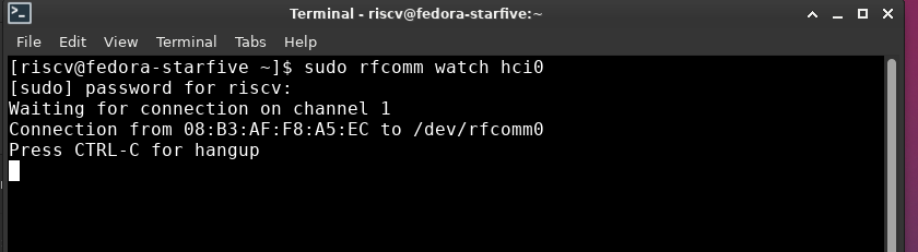

sudo rfcomm watch hci0
The upper command will help you to see whether the connection was successful or not.
If the connection is successful then you will be able to see the connected device's ID.

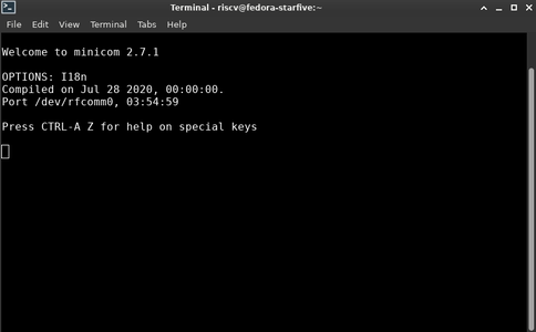

If it is done then we can move on to viewing and monitoring our data. Open a separate terminal for the following procedure.
For that, there are several tools available on Linux. We will use the Minicom tool. In my case, it was pre-installed, but if you don't find it by executing this command you can install it with:
sudo dnf install minicom -y
But I'll skip it since I already have it.
Execute the following command in this new terminal that you have opened separately. [Check The Screenshot]
sudo minicom -b 9600 -o -D /dev/rfcomm0
Baudrate can be changed with 115200 or something else if you get garbage values. But in most cases, 9600 will do the work since it is a standard value.

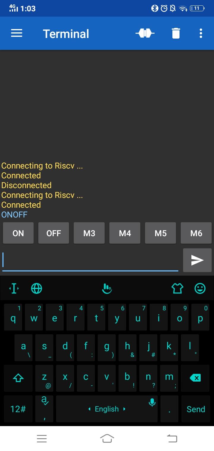

If you have everything done correctly, then until now, you have two serial Terminals opened on your desktop. On the first one, you will be seeing that your device has been paired up with your VisionFive, and on the second Your Minicom screen is up and running. And your mobile device is also in your hand.
Now if you type and send anything from the serial terminal of your App. You will be able to see it on your minicom screen.
[ScreenShot added]
Ta-Da............... It's done.

We can remove \r\n which is a carriage return and new line feed. For that simply go to the setting of your App and there select the option:
none
That's it. Now our data will be in byte format, i.e,
b'Hello World'

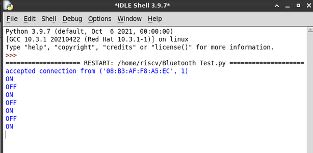

Download the file from the Github account (Link is given). and run it.
Note: Before Running the python script make sure Both devices are paired. And also no need to do anything else.
Just:
- Pair both Devices
- Run the Sketch
- Connect the app or Refresh the status by connecting and reconnecting the serial Terminal of the App while the script is running.
