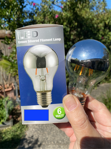

We have three low hanging pendant lights over the kitchen island and use silver crowned globes to prevent the light blinding our eyes.
I got tired of buying expensive silver crowned LED light globes that did not perform to specifications. They claim to have a 3 year warranty but never make it past 18 months.

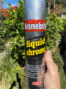

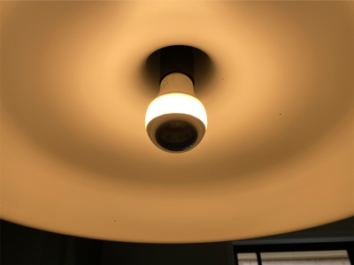

I literally had a "light bulb" moment last weekend and broke out the can of chrome spray paint to save yet another trip to the lighting store to get a replacement under warranty.
Its been a week and no sign of paint blistering or peeling off.
LED light globe(s)
Can of chrome spray paint

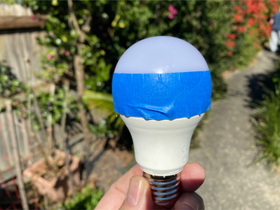

Blue paint masking tape
Iso-propanol or methylated spirits
Step 1:
Wipe down the light globe with alcohol to clean the surface.
Apply the blue masking tape evenly around the globe. You can get creative and make a wavy pattern if you like.

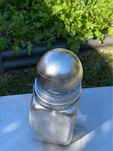

Spray the unmasked top of the globe in a well ventilated area. Apply a couple of coats.
