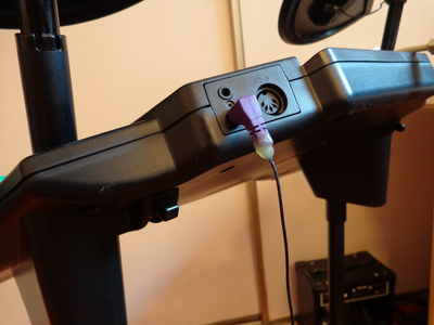

I'll be using the Guitar Hero World Tour controller for this Instructable.
It's got 3 drum pads, 2 cymbal pads, and a pedal. On the back panel, there's even 2 stereo 3.5mm audio jacks - one of which connects the bass pedal and the other we can save for any further modifications to the drumset.
Also, this set comes with a MIDI input port. Which is perfect, because we'll just save a MIDI jack and rewire this port internally and turn it into a MIDI output port.

Step 6: Back Panel Modification (Guitar Hero Controller Only)
This step is for Guitar Hero World Tour controllers only -
Since we're reusing the MIDI port on the back panel of this controller,
We'll need to make a slight modification to the back panel board. By adding a jumper between the two pins pictured above, we can ground the middle pin of the MIDI port which would otherwise be missing for a MIDI output port. We can then plug the last four pins of the cable ribbon directly into our proto board.
