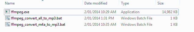

I've created two batch files as can be seen in the attached image, one for each script, but only one is required.

@echo off
setlocal enabledelayedexpansion set argCount=0 for %%x in (%*) do ( set /A argCount+=1 set "argVec[!argCount!]=%%~x" ) echo Number of processed arguments: %argCount% for /L %%i in (1,1,%argCount%) do C:\Path_to_ffmpeg\ffmpeg.exe -i "!argVec[%%i]!" -acodec libmp3lame -ab 128k "!argVec[%%i]!".mp3 PAUSE
