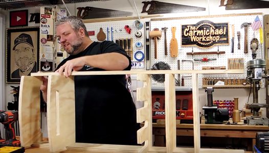

Step 4: Assembly
Space the shelves out so the openings are big enough for your tools, then drill pilot holes and screw on the sides. Use a square to make sure everything is parallel and perpendicular.
Note: I did not use glue in case I want to move the shelves around in the future.
