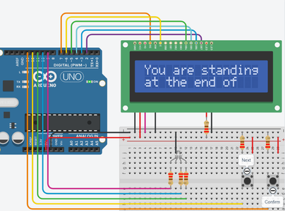

Step 1: Build the Circuit in Tinkercad
The project is composed by the following components:
  • Arduino Uno
  • A LCD screen¹ connected to pins 7, 6, 5, 4, 3, 2 (RS, E, DB4, DB5, DB6, DB7 respectively)
  • Two push buttons connected to pins 12 and 13
  • Five 220 ohm resistors
  • An RGB LED connected to pins 9, 10, 11
You can build the circuit by manually recreating the schematic above and then copying and pasting the code found here.If you want to be quick though, you can simply remix my project on Tinkercad by pressing the "Copy and Tinker" button.
¹ Tinkercad only has a 16x2 LCD, but if you're building this project with real components a bigger screen would probably be more comfortable.

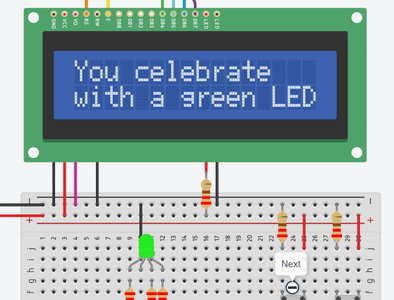

Step 4: Use Actions to Make Your Adventure More Fun
We have an adventure where we can make choices that lead to different stories. That leaves us on par with good ol' CYOA books, but hey, we're using an Arduino so let's make it more fun than that!
The way this is implemented is via what I call "actions". If you recall the data structures we defined, Messages have an "action" number. This is basically an ID that tells our program what additional code to execute at each message, such as playing a beep or blinking a LED. You can see how it works at the bottom of the sketch:
/* Calls an action corresponding to the number you put in the message. Can be anything you want! */
void activateAction(int action)
    switch(action)
    case 0:
        lightRGBLED(0, 0, 0);
        break;
    case 1:
        lightRGBLED(255, 0, 0);
        break;
    case 2:
        lightRGBLED(0, 255, 0);
        break;
    case 3:
        lightRGBLED(0, 0, 255);
        break;
Thus, if you want to add additional actions, you have to add another case with the code you want to execute and reference it in your story. If the number is not found in the switch-case, then no code will be executed, but as a convention I use "-1" be the "no action" number.
An additional note: this only allows us to add execute code during the story, but if you want to do something in the title or end screen, you must edit the "setup()" or "printEnding()" functions respectively.
