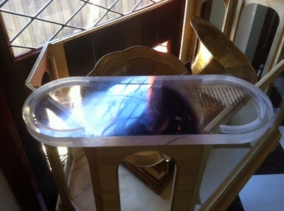

I managed to acquire some large sheets of very thick acrylic for next to nothing ($15). I wanted to create a ring of lights for a steampunk/gothic display cabinet I am making. The best thing about this project is that I found acrylic is very easy to shape/mould with a router - have a look at the results!

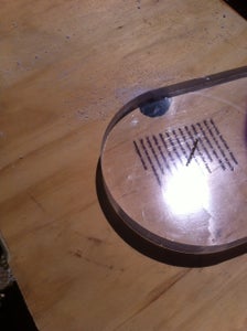

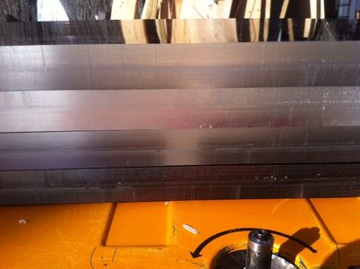

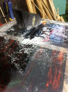

First cut the acrylic to the size you want. I cut mine into rectangles of approx 50cm x 18cm using an electric tile cutter (with a diamond blade) - don't use water, it cuts better without! My acrylic also had some old images printed on them, not very good ones I'm afraid! I made four rectangles. To clean up the sides I used a straight edged router as you can see in the stack.

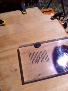

Step 3: Plywood With Drill and Routing Outside Edge of Acrylic

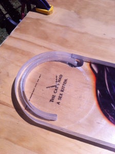

Taking a large piece of plywood I cut a hole for the router bit to pass through and then clamped it to the router table. In the picture you will see a drill sticking up out of the plywood at the radius I wanted to create for the outside edge of the acrylic. You must work from the outside to the inside! Drill a small hole in your acrylic equidistant from the edges and rout the outside edges with a straight edge router bit. I had to do it from one side first as the bit would only go a little over half-way into the acrylic, then I flipped the sheet over and cut the rest of the way. The outside edge was done first. Then I used a bull nose bit and created a channel (approx 8mm deep) in the acrylic for the wires I would be connecting all the LED's with, and then the inside edge was routed. I drilled 16 small holes (after I painted the back) spaced equally around the circumference. I will be using the acrylic I cut out of the centre for another job I have in mind.
Cutting the straight edges was a little more difficult because I used the fence. Remember that with a router you mustn't get material between the fence and the bit........but I did. I don't recommend anyone doing it this way........I pulled the acrylic toward me contrary to the direction indicated on the table and I had good control! The result is in the second to last picture.

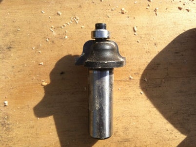

Then using the router bit shown round off the top edges using your fence as a guide.
