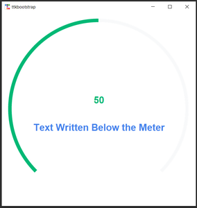

Step 2: Changing the Size of the Tkinter Meter and Adding Padding
Now that you have created the Meter,We will learn how to change the size of the tkinter (ttkbootstrap) meter widget and we will also learn to add padding to the Meter widget So they remain some distance away from the Window Margins.
Here i Will show only the Parameters that are required to control the size ,Please assume rest are there in the code.
You can use the metersize parameter in the meter() class to change the size of the meter.The values are given in pixels.
This means that the size of the meter will be 500 pixels.
Here metersize determines the diameter of the circular or semicircular gauge. A larger value will make the meter appear bigger on the screen.

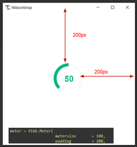

You can use the padding parameter to place the meter away from the window edges.
Here padding = 20 pixels.This adds a margin or padding around the meter. If you increase this value, the meter will be farther from the window edges.
Here is an example of different padding settings.

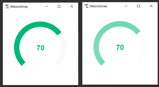

Step 4: Changing the Stripe Thickness of the Ttkbootstrap Meter Dial
Here stripethickness parameter controls the thickness of the stripes inside the meter dial.
You can have two types of meter dial,one is the continuous type one and the other is the one with segmented dial.
If the stripethickness is set to 0, the stripes blend together, creating a seamless, uninterrupted ring with no visible separation between them, as shown in the image below
For stripethickness values greater than 1, discrete, clearly defined strips become visible, as shown in the image below.
However, please note that setting stripethickness to 1 does not produce any noticeable effect,this is a quirk in the library itself
As you increase the value of the stripethickness, the individual stripes become progressively thicker and more spaced out, resulting in fewer strips overall. This effect is visually represented in the image below, where the increasing stripethickness causes each stripe to widen, reducing the total number of visible stripes in the ring

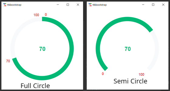

Step 5: Switching Between Semi Circle or Full Circle Meter
The ttkbootstrap meter widget is available in two distinct types
- Semi-circle Meter (as shown in the examples above)
- Full-circle Meter
To choose the desired meter type, you can use the metertype parameter within the ttkbootstrap meter() method. The two options you can set are:
Semi-circle shaped Meter
The image below demonstrates the semi-circle type meter. This type of meter fills in a counterclockwise direction, beginning from the leftmost point and moving towards the right. The layout is designed such that:
- The least value (0) is displayed at the far left.
- The maximum value (100) is positioned at the bottom right of the meter.
As the meter's value increases, the visual filling of the semi-circle moves from left to right. In the example shown, the meter is displaying a value of 70, indicating that it is about 70% of the way towards the maximum value.
In comparison to the full-circle meter, the semi-circle meter tends to save on screen real estate, making it ideal for situations where only a portion of the full circle is needed to convey the desired information.
Full Circle ttkbootstrap Meter
The image below illustrates the Full-circle meter configuration. In this setup, the meter fills in a clockwise direction, starting from the top right and moving around the circle.
In the full-circle layout:
- The minimum value (0) is located at the top-right of the meter, marking the starting point.
- The maximum value (100) is positioned at the top-left, completing the circular path.
As the meter value increases, the filling progresses from right to left, gradually sweeping around the circle. In this example, the meter is displaying a value of 70, which is shown as a portion of the circle filled up to 70% of the total capacity, indicating the current progress
