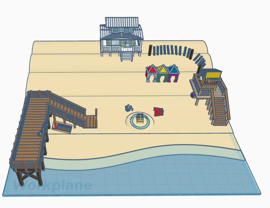

To create a design in Tinkercad, you need to use one of the basic fundamentals of the system; select shapes from the Basic Shape window and place them on the workplane to make a design. In March 2021, I learned if I used Codeblocks in Tinkercad to design an item, I could save it as a shape and use that shape in my 3D Design.
On July 20, 2022, I learned that I could make my 3D Designs into shapes, and I could use those shapes in other designs. Up until that day, when I wanted to reuse a shape, I would save it out as an STL file and import it into my design. For the house shown above, I created and 73 STL files for window, doors, columns, railing, and more. The problem with STL files, they are only a single color.
Why didn't I just copy a shape? Too much grouping in a design effects the performance of a design. I now try to limit how much grouping I do in my designs.
