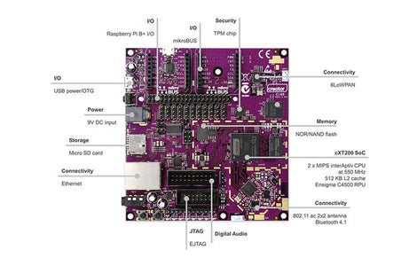

Creator Ci40 is the new IoT plaform developed by Imagination Technologies for a successful Kickstarter campaign. Ci40 uses a dual core 550Mhz MIPS processor, 2 Gb of RAM and runs OpenWRT as operating system. In terms of connectivity the board provides: WiFi, Ethernet, Bluetooth and 6LoWPAN. In this project we will toggle the board's LEDs on and off with the switches on the board using the wrappers for LEDs and switches in the LetMeCreate library.

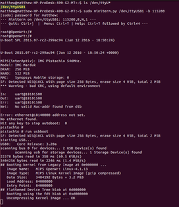

    Step 3: ​Establishing a Serial Connection
    1. To establish a serial connection with the board, open a terminal:
    2. $ ls /dev/ttyU*
    3. Will list all of the serial devices connected to the computer. If there are multiple serial devices found by this command, unplug the Ci40 and run the command again to see which has disappeared - this is the board.
    4. $ sudo miniterm.py /dev/ttyUSB1 -b 115200
    5. Will establish a serial connection with the board (where you replace /dev/ttyUSB1 with the result of the previous command)
    6. When a connection has been established, press enter. Then,
    7. # run usbboot
    8. openwrt should now boot. If the error "ERROR: can't get kernel image!" appears, unplug the USB containing openwrt and plug it in again. Alternatively, press the reset button on the edge of the board. Then, press any key to prevent autoboot and attempt the previous step again
    9. Now openwrt will boot. Once the timestamps have stopped appearing (usually around 35 seconds), press enter to activate the console
