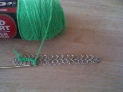

Using pliers(or whatever you're comfortable with) start off with a strip euro 4 in 1 chainmaille weave using the 3/8 inch jump rings.
Step 3: Inter-weave
Loop your yarn on the hook and feed the yarn through the center links of the chainmaille.
Single stitch with the yarn and poke the hook again through the center link and repeat as many times as necessary.

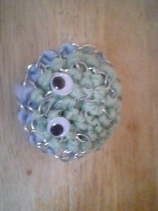

Step 5: Variants :Armor-gurumi
This is a variation of the crochainmaille.."Armorgurumi " a play on words of amigurumi..
This Armorgurumi Clam was made with 4 in 1 "in the round" chainmaille weaved with blue and green yarn working from the outside in.
It's heavy and can make for a wicked hacky sack as well
