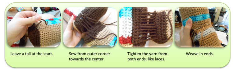

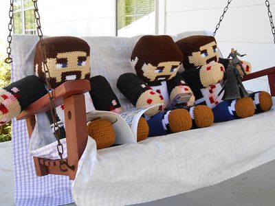

Attach the legs. (Make sure you know the right from the left before you sew!) (Image 2)
  • Cut an 18 inch piece of coordinating yarn for each leg.
  • Sew from the outer edge of the chest to the middle of the chest, along the bottom front edge only. Leave a long tail (4‐6 inches) at the beginning; you will knot it off later. (This will allow the plushie to sit without stretching the bottom panel of the chest.)
  • Your stitches should be deliberately loose, so that you will have room to work with your yarn needle.
  • At the end of the leg, go back and tighten all the stitches by pulling gently (like lacing up sneakers).
  • Knot both ends of your yarn and weave ends in. (When weaving the ends in, I weave them all the way back to the opposite end of the seam, and knot them again for the most strength.)
Attach the arms. (Image 2)
  • Cut an 18 inch piece of coordinating yarn for each arm.
  • Sew from the back of the chest to the front along the top side edges. Repeat the leg instructions.
