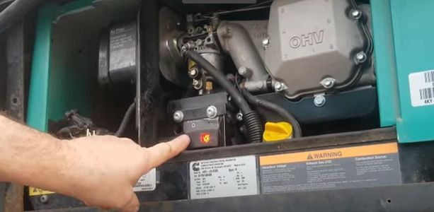

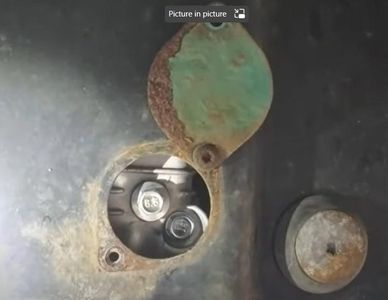

Step 2: Open Access Port
Watch Video it helps support the Instructables

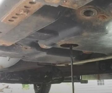

Step 3: Drain Oil Into the Catch Pan
Remove plug WARNING OIL IS HOT!

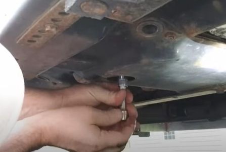

Step 4: Reinstall Plug
Be sure not to lose the seal washer in this process

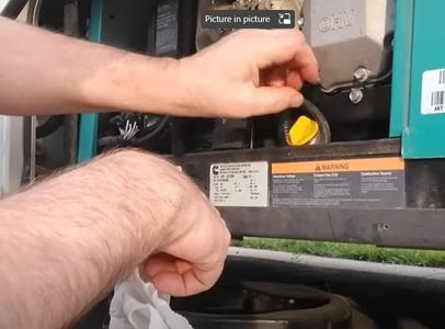

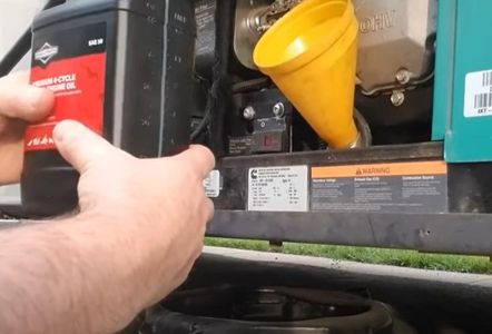

Step 5: Add Oil
See video for the volume of oil
Step 6: Start Generator
Stop generator check for leaks and oil level
