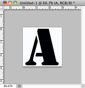

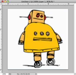

Step 2: Select Your Image

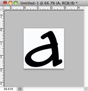

  1. Decide what you'd like on your cupcakes: Simple bold images, line drawings, or letters work best - a single letter for a person's birthday, for example. While images with more detail (like the awesome robot shown here) are fun, they can get a little blurry when stenciling so something simpler is suggested. You can also make multi-stencil designs (as shown here) if you want the end product to be two-toned (that's a bit more complex)
  2. Open your image-editing software and create a new file
  3. Add the image you have selected to this new file

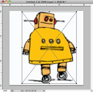

  4. Make adjustments to the image or text so that it will stencil properly. If you have areas that are "floating" you will need to find a way to connect them to the area around the portion of the stencil that will be cut

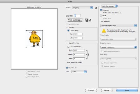

  5. Resize the image so that it is 3" at the largest point. This will make the stencil the correct size for the top of a standard cupcake
  6. Print your image
