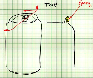

Before we remove the top of the can we should first realize how the construction of the can allows us to do this.
Since cans are made through a deep draw process and then a hemming process the can can be carefully disassembled.
Step 2: Rip It Good
So now we know how the can is constructed, we can now rip the top off. If you can remove it in a circular motion the can will tear along its hem.
Once the top is torn off, the hem will still be attached by its lower half and epoxy.
To get the lower hem off you must rip the lower hem so it will dislodge itself from the underside of the hem.
Once that is finished you must bend the inside top flange upward and outward. Just make sure that the flange from the can stays intact.
After the hemmed part is bent upward you can peel the lower hem downward and off of the can.
Now that your Hem is off the can, all you have to do is wash it out and and remove the epoxy.
The can is finished!
Recycling at its easiest. Their also dishwasher safe!
