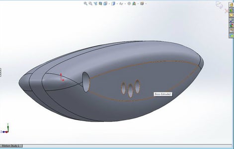

This is where we design the actual lure. Unfortunately, I lost the image of the 2D profile and don't have access to my software, so I can't replicate it. But that doesn't matter, as this is the step where we can get creative! Once you've decided the length of your own fishing lure, lay a straight line square to the axises slightly shorter than your lure length. I made a line 65 mm long, and my lure turned out slightly longer. Now use the spline tool, select the endpoint, and just eyeball it, until you get a shape reminiscent of a fish. Mine turned out slightly oval shaped and lopsided, similar in profile to a anchovy or minnow.

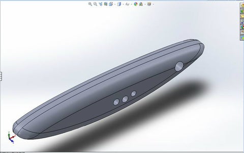

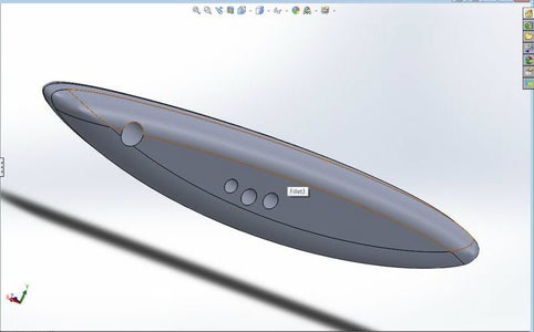

You may need to select two or three times, until you get a shape and size you're satisfied with. Now that you have the basic profile of the fish designed, delete the center line, and extrude it outwards to a reasonable thickness. I adjusted mine between 10 and 15 millimeters, until I got a shape and profile that seemed proportional. Then use the fillet tool with a radius of 2-3 millimeters, to create the rounded fish shape. Then go into sketch mode once again, and draw the circles on the sides, top, and bottom where you wish to extrude holes to attach the hook, line, and any weights or lure components such as spinners to.
I put 4 holes in the side on mine to attach the hook, and to even stuff power bait inside to help attract fish. Just make sure to make at least two holes, one horizontal in the head, and one vertical in the tail so you can ballast the lure, and attach it to a line and finish it with proper lure components.
It doesn't matter if they're on the actual face of the object, you can adjust the extrude cut and it will always be able to cut through the object, regardless of orientation and placement. Make sure to know the resolution and limitations of the printer you're using, several slots and holes I designed in mine had to be hollowed out by hand after the support material filled them and couldn't be removed in the calcium carbide bath. Because of this, I had to use CA glue to adhere the hook to my lure, and wrapped it tightly with fishing line to secure it. Now navigate to the top of the menu, select the dropper, and export the file as a .STL.
