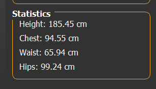

For now, we're going to skip directly to the last tab at the top labelled "Measure." Here is where we'll start putting in our actual measurements. On the top right of your screen, you'll see a checklist with a list starting with neck and ending with ankle. When selected, the measurements for each can be adjusted using the sliders on the right. When you select a slider, it shows you the exact place to measure. Above is an example of what it looks like when I select "neck circumference." Use a flexible measuring tape to measure as you go down the checklist.
It may seem strange but, even if you're only making a torso dress form like I did, don't skip putting in any of these measurements. You'd be surprised how much information you can get about a person by the width of, say, their ankle, and the idea of this is to be as accurate as possible. Besides, later down the line you may want to make a leg form, or a halloween prop. Having a 3d model of yourself is endlessly useful. Also, Write down your measurements as you take them. You will have to go back and readjust them after step 3.

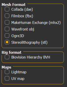

Our next program, TinkerCAD, needs an STL. To get this, click on the "Export" icon. It's a little save button with an arrow, third from the right on the top. From there, select the STL option. Ignore every other setting, except the "Scale Units" where you need to select "Centimeters" unless you changed the units on your own. Hopefully you didn't or the math is about to get really un-fun. The export button is unfairly tiny, so I drew an arrow pointing to it.

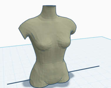

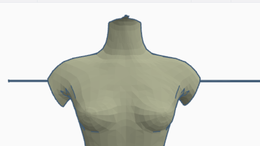

TinkerCAD is going to be where we slice up the model for our cardboard template. But first, we need to prepare it by removing excess limbs and adding a hole for the base. Google TinkerCAD and make an account. Open a new 3D design space and right off the bat, we need to change some things. Go to "Settings" on the bottom left and change the units to millimeters. Then in "Snap Grid" change it to 0.1 mm. Now we can import our file.
TinkerCAD can't handle a file the full size of a human. So, we're going to scale it 10:1 (Scale to 10%) in this step. Thankfully, since we did this in centimeters, we can just import it in millimeters. A millimeter is 1/10th of a centimeter so this just does everything for us.

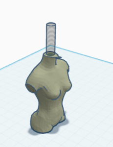

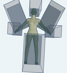

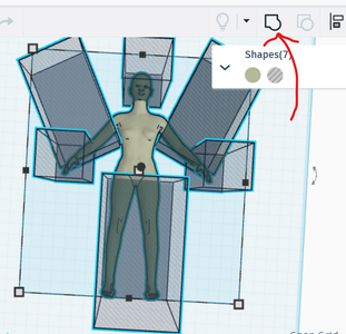

To lop off the limbs, we need to use what I call the "Negative Box." This, to my knowledge, isn't what it's actually called. Though, that's only because the people at TinkerCAD won't take my call. But there's a negative box and a negative cylinder and they both delete what's inside them. I've drawn an arrow to them, they're white with gray stripes. Drag and resize these negative boxes over the body model until it looks like the example photo.

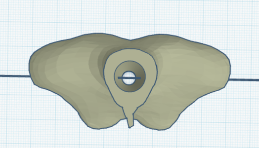

Next, take whatever you're using for a base and measure the diameter in centimeters. We're going to cut a cylindrical hole for it. I used a mailing tube, but you might be building a PVC base. Then, make a negative cylinder of the same diameter, but in millimeters. No math required, just put in the same number. Put it in the middle of your model and group
You need to add one more negative cylinder. The purpose of this one is to serve as a registration mark for when you're putting tabs in the vertical pieces. This registration mark will tell us how far the tabs cut into each vertical piece. We don't need these for the horizontal piece, because the negative cylinder for the base does it already.
Make a long negative cylinder and make the diameter .05 cm. Then turn it 90 degrees so it's horizontal and move it so it intersects the middle of the negative cylinder we cut for the base. Then, from the front of the model, move it up to the widest point of the shoulders. Group the objects and repeat this process, but for the widest point of the hips.

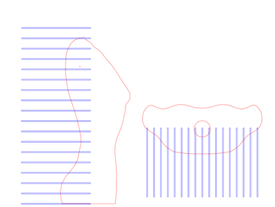

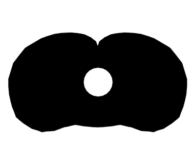

Now you need to decide how many layers of cardboard you want. I probably went overboard. But the more layers, the better the accuracy. My layers wound up being about an inch apart. For the first layer, Go to "Export" and export an SVG. It will look like the image above.

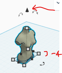

Divide how many vertical layers you want by the height. Then you need to use the movement tool to break up the model. The vertical movement tool looks like a cone hovering over your model. Click it, and a unit box pops up. Simply type in the answer to your equation and hit enter. This will lower the model beneath the plane by that amount. Repeat until you've made all of the layers, then repeat this with the horizontal slices.

To add the tabs, use the distance you got from the previous step. The tabs for the horizontal pieces should go from the very middle of the circle cut for the base and out to the front. The vertical pieces should have tabs that go from the middle of the registration marks we made earlier, and out to the back. This way they can be slotted together.
Whether you do this in a paint program or by hand, the best way is to make yourself a template. Make little rectangles a tiny bit wider than your cardboard and space them out the same distance as your model slices. Then you can just superimpose, (or place, if you're drawing by hand) your template over your cardboard piece and life is easy. Some pieces may get lopped off in the process. This is fine and they can be glued. But make sure you label them!
