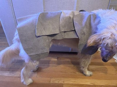

Step 5: Armor: D; Cutting First Layer
I traced what I planned to be my first layer of the armor on my fabric, which you can see above.
For my choice of fabric, I chose a gray that slightly reflected light (similar to how velvet would) in an armor-ish way to appear somewhat like metal. Above is also a picture of me testing the first layer out on my dog (just to make sure (again) that I didn't mess anything up!)
That triangle on the bottom of my tracing is where I'm planning to cinch the fabric to better fit her rump, which helps make it look less blocky and more dimensional.
Remember, the photo above is not the finished look! That's only the first layer! If you'd like to make it easier for yourself, you can cut it all in one big piece and not have a layered design.
Step 6: Armor: E; Cutting Next Layers
For the next two main pieces, I cut out an artistic oval-shaped shape (with the fabric folded over so I could cut two at once and have them mirrored and the same shape) for the shoulder pads, and two back plates with a gentle inverted-arrow design (slightly smaller width-wise than the long back plate). For the back plates, I slightly folded over and glued the edges (not including the straight back end which will be under other pieces due to the layering of the design) to give it better dimension and not look so flat.
In the photos above, I had not yet cinched the back, so it looks more fitted once I do.

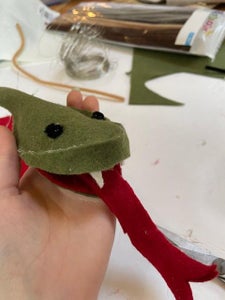

Step 10: Snake Tail: C; Head
There are a few simple steps to assembling the snake head:
Base: Cut out two identical green pieces of felt for the top and bottom of the head (in green pattern shown above), and glue only up to where you'd like the mouth to open. Make sure to leave open flaps on the top and bottom in the back of the head for attaching it to the body! Following this, cut out a diamond shape from red felt to fold and glue inside of the mouth. With the excess of the mirrored green snake head design, make the upper lip of the snake and glue it to the top of the mouth.
Tongue: cut out two identical strips of red felt with two outward-moving points to look like a snake's tongue. Glue a wire on top of one of the pieces, then glue the two tongue pieces together with the wire between them. This will give the tongue the ability to be shaped and curved. Glue the tongue as far inside the mouth as you think looks natural.
Teeth and eyes: cut two small triangle shaped teeth out of white felt. Glue these about an inch apart inside of the snake's upper lip. For the eyes, I cut two small pieces of black pipe cleaner and curled them into circles, then hot glued them on top of the snake's head.
Having followed all of these steps: you've finished the snake head!
