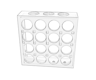

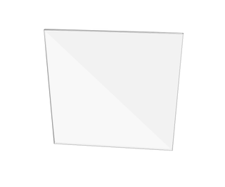

Step 4: Step 4: the Case
I 3d printed my case and I'll include all the sketch up and makerbot files here. You might have to sand down some holes depending on your wire and pot sizes.
